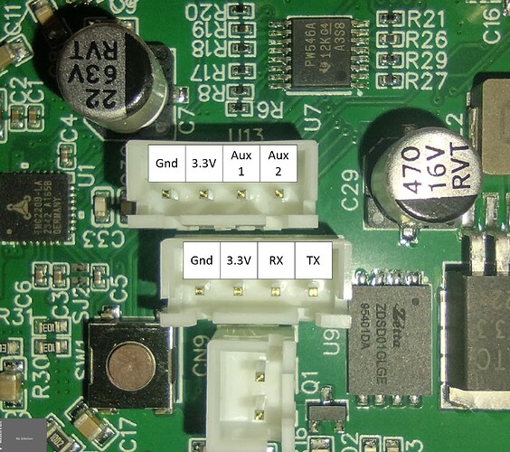

I’ve not seen the Maslow 4 schematic yet. Q: What IO is drawn out to through-holes for pin headers - I2C, SDIO, 3v3 TX/RX, GPIO, PWM, etc. ? These IO will be important for the community to enhance the firmware & their Maslow’s features.

There is already an AUX connector on the board…It’s a JST-XH connector, but those have the same pin spacing as a header if you want to connect that way, they’re just a little more secure…right now it has 3.3v, GND, Serial TX/RX and I believe we will have two extra GPIO pins, but it’s possible that there will be four. I will be sure to break out any unused GPIO for expansion.

Would it be possible to get the pinout and mapping for the GPIO? I assume it is one or both of these connectors?

Absolutely. The pin out on those looks like this:
And on the ESP32 side we have:
To make it a little easier to process, here is bar’s pinout as it looks on the board.
tyvm for the pics. super helpful. After some light cross referencing this morning, it appears this ESP32-S3 isn’t built with leads for i2c, sdio, etc. - just gpio, usb, serial, spi for psram only, etc. It appear specifically built for projects the RTC potential and heavy GPIO.
Too bad Espressif didn’t include i2c as it would have allows for all sorts of feedback sensors, displays, triggers, and more off two pins vs possibly sacrificing gpio for detection. Then again, i2c would need polling where gpio could have faster detection (important for heavy equipment.)
Given we’ve only two GPIO, besides UART, I wonder what folks will come up with. I’ve not dug into FluidNC to see what they could be best served as for the Maslow4 use-cases. Guess Darwin’s “survival of the fittest” will determine that. XD
