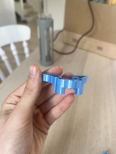

Are you guys printing these covers in PETG or PLA?
I did PLA and it was fine. They don’t have any strain or heat to worry about.
I use PLA Pro or PLA Plus. No issues.
Just printed it off with Prusa Slicer and still had some thin wall defects. Printed at 0.15mm Layer height with PLA. @bar
@Ghinton Can you be more specific? Which model did you print? Where did find the defect? Have a picture?
Printed V8
