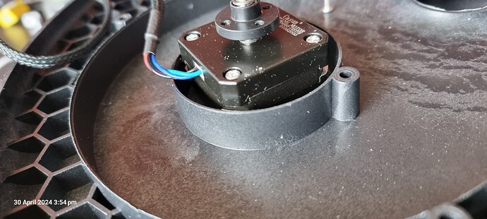

Got my 4 yesterday, so have been putting it together. There’s quite a few places where the bolts don’t actually have enough length to reach the lock nut locking plastic! Which seems like a waste, for want of 2mm more bolt.
The strain and wear relief on the steppers for the z are rather poor.
(And the next post)
I’ve already added a bit of tape.
The last thing is, of course, the reliance on the Dewalt 611 router, which seems to be almost unknown in the UK - I’ll likely have to mod it to use something else. (I’m actually thinking of trying the Ryobi 18V ā€œpalm routerā€ for a battery solution throughout…)
The other stepper:
Can you post a photo how you added strain relief? That could be helpful for others. Cheers

I literally just put the last of a roll of insulation tape round it. It’s more to stop the abrasion that the sleeve should have, but won’t becuase it’s a few inches down the lead!.
