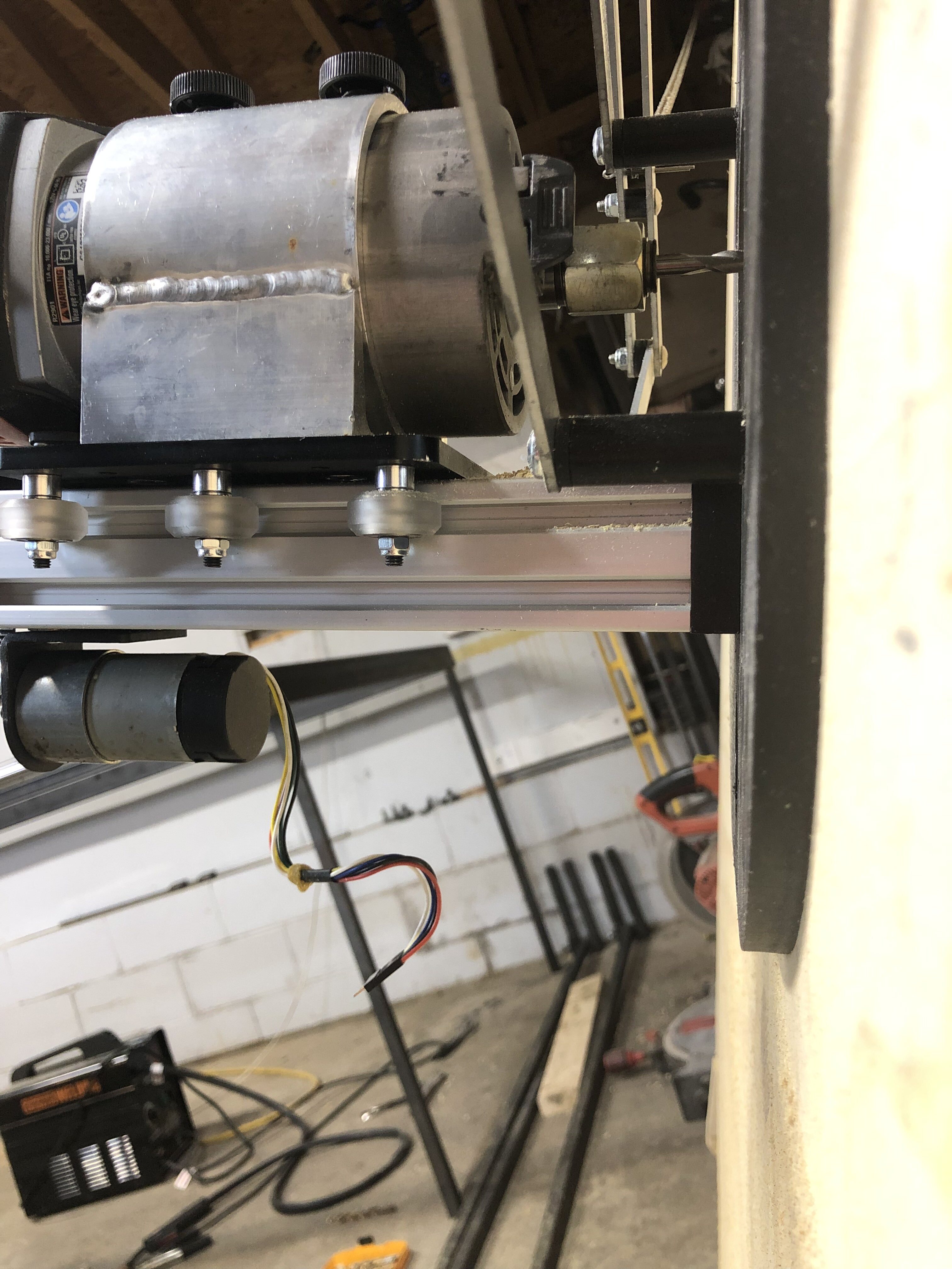

Started using the metal z-axis kit and I’m not understanding the jumpy hard cuts going on here. The router is secure, everything is tight and the router is real jumpy and deforming the cut. I had to back away from the machine I was afraid the bit would break off. What am I missing. I know if I go back to the previous wood sled I wouldn’t see this.
I came from a dlang metal kit and a custom wood sled with weights and the cuts are real smooth.

that’s a pretty aggressive depth of cut. in the last video, the problems when cutting down are that the sled is not sliding smoothly enough, and the bit isn’t cutting fast enough (the bit may be getting dull, that happens really quickly if it gets hot), so the sled seems to stutter a bit
It also looks like the bolts holding the linkages are just a little too tight so they don’t move as smoothly as they could
try waxing the bottom of the sled (or trying the plastic ring around the edge), loosen the bolts a smidge, and try a new bit. you can also try shallower cuts

It’s interesting that the router wants to smooth out on horizontal cuts. The tower appears perpendicular… There is some movement between the router and tower but I’ve seen that on my previous sled.
few things you should do:
  1. Add 1/2" of rise to your 4 linkage arms, the kit should of had some washer or square risers to help keep center of balance. The 1.5" risers included are for the smaller routers, for a big 9 lbs router you need about 2" of rise.
  2. set the bottom of the router to be at the bottom of the clamp. This will allow the gantry plate to ride lower thus being more stable. just an inch or 2 makes a big difference.
  3. you have too much play in your gantry.
    https://youtu.be/OKe5Pa23JrI?t=360
    you need to watch above video at 6 min mark and tighten up the 3 eccentric nuts all on the same side. the nut is 6 sided. if the side that has a dent in it is facing out it is at the loosest setting, if facing in at tightest setting.
  4. less aggressive cut depth Recommend no more than 1/2 the diameter of the router or 1/8" in your case. The old wooden sled had a 360 router base to support the router, this one does not have that so you can’t be super aggressive.

I installed the risers that came with the kit and unfortunately that leaves me 3/4" of z-axis travel, and that’s with the router seated in the clamp not leaving me any room try your suggestion #2. You mentioned I need about a 2" rise that would leave me even less z-axis travel. The gantry runs into the screw below it. Please see the video.

I did not. I will say that lower feed and spindle speeds were required for smooth cuts.
I ended up tearing down my Maslow and building a more traditional cnc machine. I felt like I was more focused on getting the machine working instead of making things.
the lowest speed of 10,000rpm is recommended for ALL maslow setups.
and a depth of cut equal to or less than bit diameter is also recommended for all setups. I think trying to cut 3/4" at once is pushing the machine way too much.
Trying to cut deeper than that can be done, but not recommended. Building a traditional cnc was probabaly the way to go.
