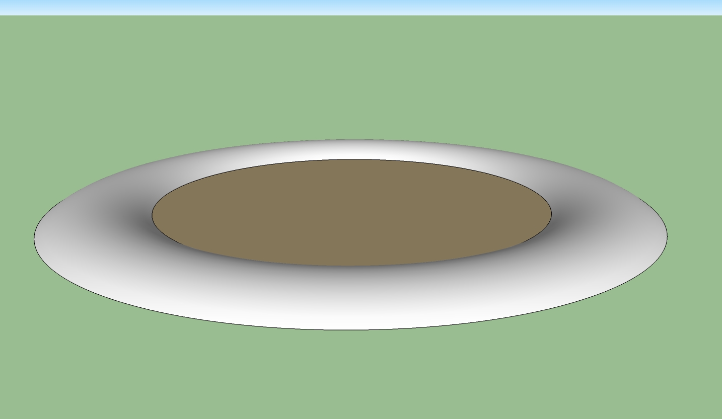

Another render possibly like this. Then again maybe I’m all wet and my analysis is way off.
Ball bearings are point sources quite different, apples to oranges comparison.
there is FLAT bottomed UHMW trim available. Of course the wider the trim the harder it is to bend into a tight circle. Anyways vast majority are not doing pocket operations, just simple cuts with a 1/4" bit kerf. I cannot recall seeing any projects where a perimeter trim would cause an issue. Even the cell pc case which is about as holy as you can get should work. Of course now that I say this, someone will post a project that might cause an issue and I will have to eat crow. lol.
We’ve done some testing with a wooden version like this. One of the issues we saw was a change in bit angle when negotiating a change. So if we only had single passes cutting out a project, it was fine. But if we were making a sign with multiple sections of missing material, it would “wobble” ever so slightly when advancing across the dips and valleys in the project.
Decreasing depth per pass and using a smaller diameter bit can make this less noticeable, but also add time to the job.
With that said, I still think this design has its use cases and offers a lot of improvements over a fully flat surface.
Many ball bearings arranged on the perimeter would act essentially the same. The point was illustrative not practical. Anything that comes to a limited point of contact is doing to be subject to the same problem. Although it reduces surface contact and one would thing friction as well, MMC’s post above is exactly what I would expect to happen. YMMV
any sled will have issues with missing material that is about 50% size of the sled, for best results one should not have missing material at all, do not remove pieces until the full piece of plywood is cut… I think one test using plywood missing pieces is not very conclusive. more tests need to be done under normal circumstances. (no missing material)
Totally agree with not removing pieces during a cut. Our observations were made on a project that had some carves involved where the material was removed in passes and keeping it wasn’t an option.

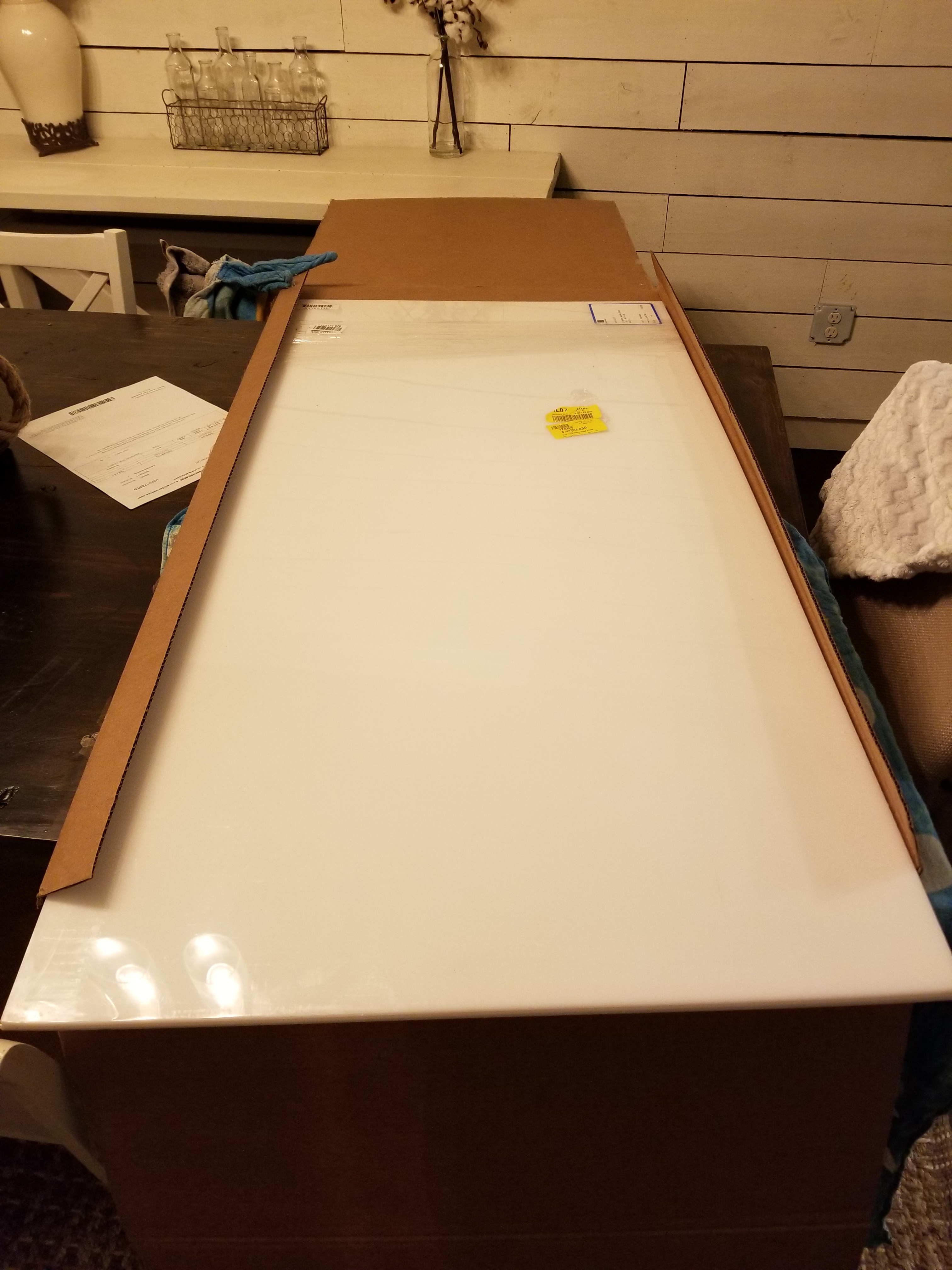

Came home to 3 sheets of 1/8" HDPE today!
Still waiting on UHMW.
I would be willing to do some testing if needed.
Thanks ,
Mike
make sure you specify that the UHMW sheet needs to be flat. I’ve bought some in the past that was really wavy. Maybe some Is extruded vs cast? or different grade? not sure.
Thanks for the tip! What we ordered recently was just described as “sheet”, hopefully we don’t run into any issues. Will definitely be making sure we provide more detail specs when we go into production now.
