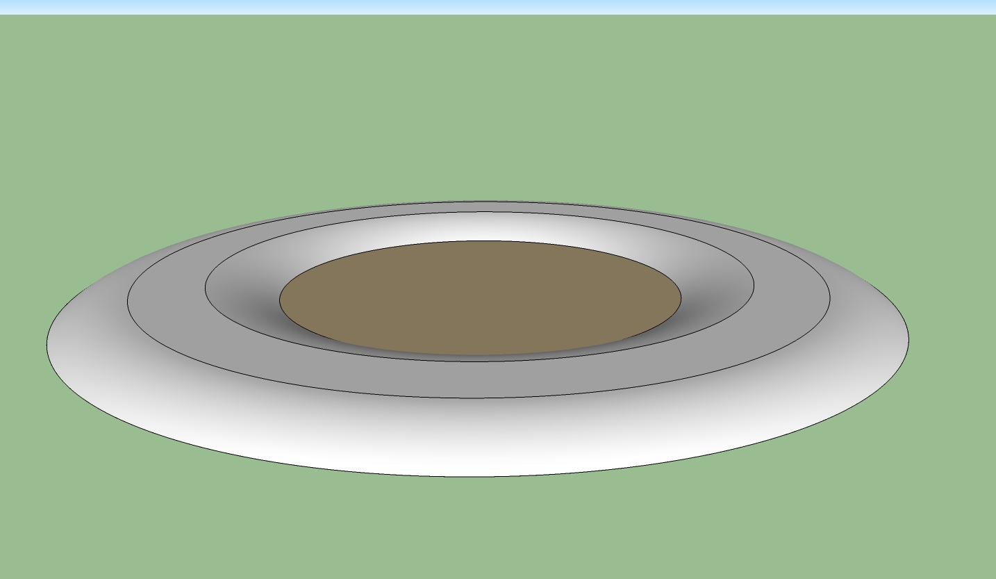

If the outside edge doesn’t catch the work then the inside edge wont’ either as long as it’s rounded over as the drawing illustrates. In theory the pocket would have to be over 50% of the sled area for the sled to potentially fall in, and with a 18" sled that pocket would be huge. Valid points, but probabaly never real life issues IMHO.

What about 1/2 clear lexan . It would be nice to see the past and future cut , as well as being able to the dust collection cavity if incorporated into the sled.
lexan is pretty expensive, scratches easily and attracts dust, there is a scratch resistant version of it, but that is 2x the cost and most laser cutter places will not cut it due to fumes it makes and it’s tendency to self fuse. it can be done, but not sure it would be economical. some windows in a steel sled would accomplish similar visual peeking.
I agree with what you are saying David, I have tried to envison ball bearing on the bottom or small wheels which would act like the permimeter mounted material in my estimation. At the very least you are going to get a bump or deflection when the sled crossed cut lines on the edge of forward travel.

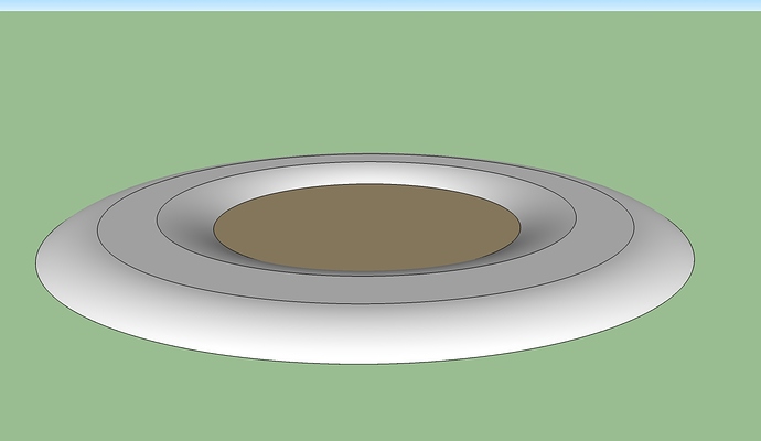

If a perimeter riding surface is the goal I think you would need a much wider portion than in @aluminumwelder has in the image above with a very wide and shallow sloped outer portion to minimize jolts and hangups.
Something like this? I sloped the inside and outside on this one.
