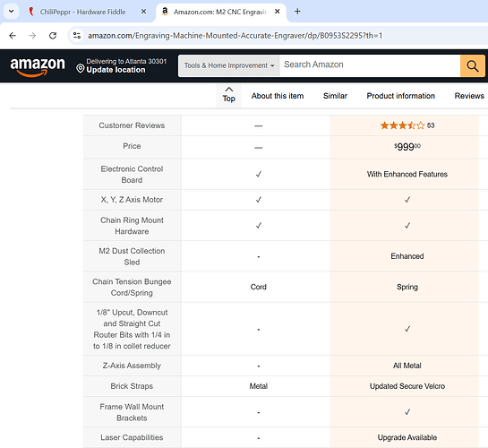

I use Carbide to make my svg. file. then I converted it to g-code using Easel. now i need software to use on my Maslow m2 cnc machine. (ground control) help me please and thank you.
Depends on the version or M2 you have. If it’s a Duo board you can’t use ground control and have have to use Makermades (different manufacturer) program. If it has a Arduino you can use groundcontrol, though I’d use webcontrol.
If you are using Carbide Create v6 to make your svg file, you can use that to generate your gcode as well.
This is what I have. (photos below) i believe it is not a duo board because I only have 1 unit that everything plugs into.
If you have or know any other free programs I can use, please drop a link.
Sorry DUE board. If your sled is all blue like the one you posted you have a DUE board. Webcontrol and groundcontrol will not work with that boards. You will need Makerhub to control your machine.
Here is the link to Carbide Create v6
That machine isn’t actually a Maslow, it’s a Chinese knockoff and they have their own software :confused:
