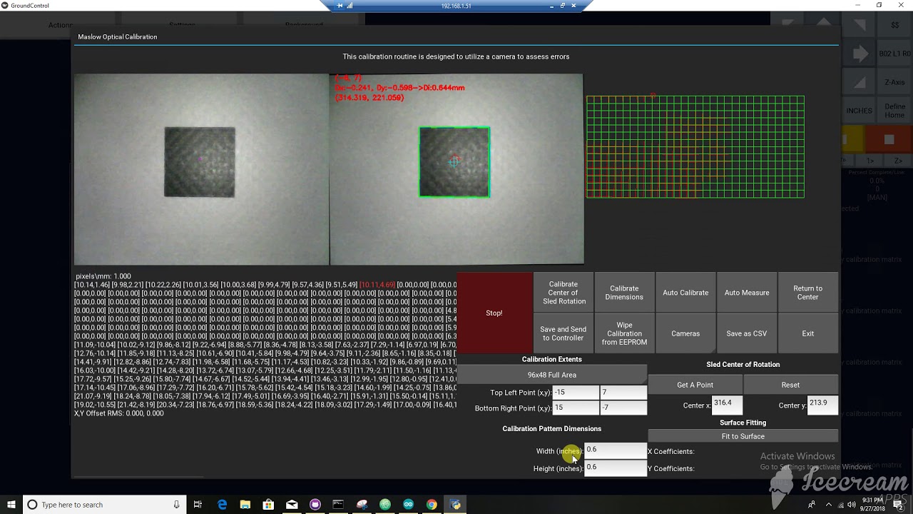

The routine does image processing by converting the image to gray scale, blurring it, doing edge detection, dilating the edges and then dissolving the edges so you get contiguous lines. If an edge is really a shadow, it might or might not pick up on the hard edge. also, if the camera is off center, the hard edge will be shifted because it’s elevated in the Z plane. The concern about the wood grain is whether or not it would be detected as an edge. I think with a big enough square, that won’t be a concern because I use the largest contour found.

When you get around to it, take a look at the findCenter branch… I’ve reworked the gui some (rearranged buttons, made the presets into a spinner) and added a section to do a curve fit to a quadratic equation. It prints the coefficients on the screen and then uses them in the grid display to show what the equation would produce. Without full sheet data, I don’t think it will do a very good job of curve fitting because of the discontinuities… but we’ll see this weekend what a full sheet looks like.
The firmware also saves the matrix to eeprom but if the curve fit model works well enough, then we won’t need anything special but adding maybe 12 new variables to the settings (6 coefficients per error axis).
I like the idea of using a curve fit formula as it will smooth out the calibration matrix which I hope will improve its accuracy even more.

Here’s a video of the latest calibration routine running through the full test… it’s only the first few scans across the board (the software I have stops at 5 minutes). But if you’ve seen one square calibrated, you’ve seen 465 squares calibrated…

Each reading is 3-inches on center with the first reading three inches from the top and left. So there are a total of 31 readings horizontally, with the center “column” being at reading 15 and 15 readings vertical with the center “row” being at reading 7, so the center of the board(0,0) is reading 15,7 in each matrix.
The coordinate space Maslow uses is that values increase from left to right and decrease from top to bottom. If, for example, the controller was trying to get to -100 mm, +100 mm and the x,y error was 5 mm, 6 mm, the controller would calculate the chain lengths needed to go to -95 mm, 106 mm. However, the calculation is made a little different than just taking the value from the matrix.
The routine actually uses the center reading to modify the location of the motors so that there is no correction needed at the center point. Here, the Xerror at 15,7 in the data is 12.95 mm and the Yerror is 5.45. The firmware uses these values and shifts the position of both motors to the left by 12.95 mm and down by 5.45 mm. This causes the controller to redetermine it’s coordinates and when you issue a Move to Center command, it goes to 0,0. Then, when the controller receives a command to move to a certain set of x,y coordinates, it adds the associated Xerror and Yerror from the calibration matrix and subtracts the center’s Xerror and Yerror. I did this because when I didn’t do it that way, everytime I tried to make a move after setting the calibration, I got “sled not keeping up error” and it stopped working. By readjusting the motors for the center position, the problem went away. Why? I’m not entirely sure, but that’s how it works.
