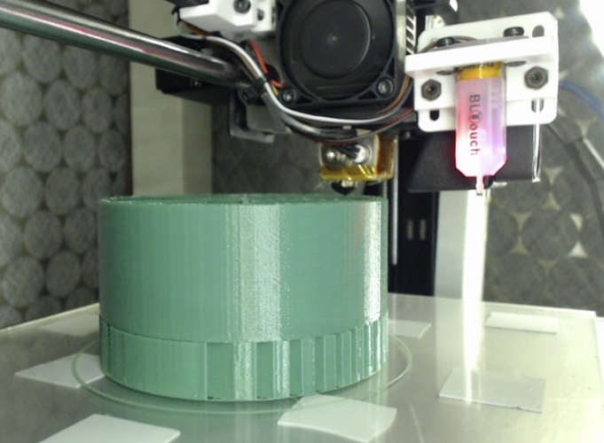

Nothing seems to come out to the correct scale whenever I print things… I don’t know if its a calibration issue with the printer or that PLA shrinks. I think I’m just going to have to use the drill press and try my best to get the hole in a 1/2-inch dowel in the middle of it.
PLA does shrink by ~10% as it cools (more if you treat it afterwards)
It came out too small? How far off was it? I’m using petg which avoids shrinkage. But I also found that my Wanhao i3 Plus clone had the incorrect steps per mm setting from the factory, so you might have something to adjust on the printer also.
Most slicers can easily scale models also. So might be worth a try measuring how much smaller yours came out as then scaling the appropriate amount in the slicer.
More like 2%
Thanks for the correction
Print a 10 mm cube and 100 mm cube - from there you can calc “correction and scale”
Yesterday I scaled it up by 1.07 (I found on the internet that pla shrank 7%… not saying its, right, just what I found) but the piece came out too big and the inside hexagon for the pencil was too small. So, I measured today and came up with 1.049 as the scale factor… so I used 1.045. I then increased the size of the hexagon some and the print looks much better. Can’t test it until tomorrow, but I think it will fit.
you have two factors
  1. the material shrings as it freezes
  2. the 3D printer is printing a wide line, and your cad is for the center of the
    line, so you have to move the line in the cad over by half the width of the
    layer (and since that depends on your extrusion rate and movement rate, it is
    non-trivial to calculate, so you end up tweaking it until it prints the way you
    want)
+1 this rings true to me.
For #2 you can do an e-step calibration. Also check your filament diameter with calipers and make sure your slicer is set accordingly. Finally you can tweak line width by adjusting the flow percentage in most slicers. I think I have my petg set to 95% flow because I found experimentally that my line width was too big otherwise
