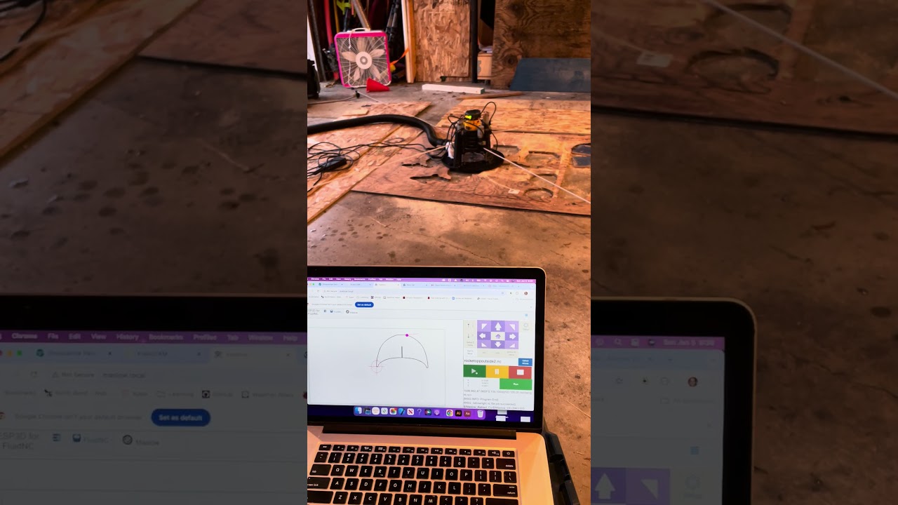

Hey, I have made numerous cuts over the last couple of months without issue. And then tonight, the dreaded position error came back over and over again in the same spot. I was able to finally make the cut by starting the router in a position other than my home position. After finishing, I adjusted the height up and turned the router off. Set the router back to the same home position, pressed run and it failed again at the exact same spot…
I am running older firmware from the summer will try updating soon.
I have the hot glue on my plugs.

[MSG:INFO: Top Right pulled tight with offset -2490.729]
[MSG:INFO: Top Left pulled tight with offset -2376.701]
[MSG:INFO: Bottom Right pulled tight with offset -2663.934]
[MSG:INFO: Bottom Left pulled tight with offset -2730.165]
[MSG:INFO: Bottom Left pulled tight with offset 0.021]
[MSG:INFO: Bottom Right pulled tight with offset -28.977]
[MSG:INFO: Top Right pulled tight with offset -90.913]
[MSG:INFO: Top Left pulled tight with offset -188.246]
[MSG:INFO: Top Right pulled tight with offset -0.011]
[MSG:INFO: Bottom Left pulled tight with offset 0.000]
[MSG:INFO: Bottom Right pulled tight with offset -0.011]
[MSG:INFO: Top Left pulled tight with offset -45.242]
[MSG:INFO: Center point deviation: TL: -0.036 TR: 0.169 BL: -0.283 BR: 4.794]
[MSG:INFO: Center point deviation within 15.000mm, your coordinate system is accurate]
Jog: Z0.1
Home pos set for: Z
[G54:-303.404,-242.324,29.130]
Jog: Z0.1
[MSG:WARN: Position error on Top Right axis exceeded 15mm while running. Error is 15.027mm Counter: 1]

Here is a video of the working. (Did several good cuts prior this morning). It has a safe non center home position.
Here is a video of it failing. (Moved the home position) https://youtube.com/shorts/QHwj2ktVbT8

It seems to fail at the approximate center of the frame. For example, it fails, I turn off power, retract belts, extend belts, apply tension, the Maslow does not move since it is exactly where it failed.
So to answer your question, move from the bottom left at a 45 degree angle to the top right. Just crossing the center from left to right is not enough. It has to be left to right and bottom to top all at once.
The cut succeeds if you manually move the Maslow up, then to the right to the approximate starting point and then start. It just drives around the center of the frame but never crosses the center.
I’m thinking about setting up a “X” pattern to cut with the center of the “X” at home and home at the center of the frame.
