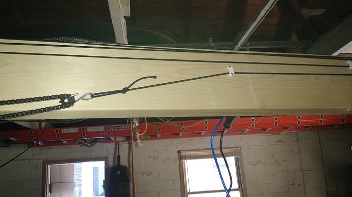

I was able to snap some photos this morning. Here they are:
Here is an image lookiing down the beam. The left motor is just to the left of the photo, now shown. The right cord bearing is about 2’ away from the left motor. The cords start on one side, cross in the middle, extend all the way to the other side, go around the bearing, go through the wire-staple, and connect to the chain.
The extended length means the tension on the chain is fairly close to constant through the range of motion. The photos show the limit of motion for both chains, in the closest position.
Here is a photo of the center of the beam, of the wire staples.

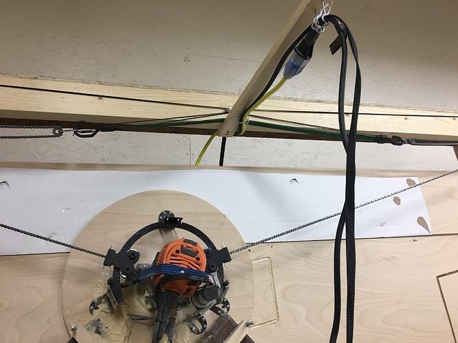

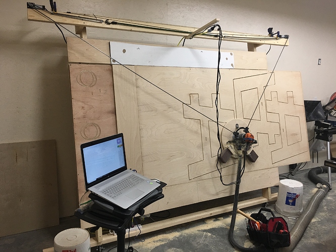

After getting my Maslow calibrated, I couldn’t wait to cut something, so I pulled a file that I set up while waiting for the hardware to arrive… a set of folding saw horses for a workbench I will build with all CNC cut parts. Although I thought I had tuned up the shock cord system, when the sled got near the top of the board, the loose ends of the chain crossed the drive chain, and I was fearful of a chain tangle or a skip. I paused the cut, and, remembering posts about using stronger bungee cords, scrounged around and found a cord that was about 30ā€long, and could stretch to 84ā€. Seemed like a good rage for the Maslow, so I just hooked it across the two sides on the same hooks as the provided stretchy cord…
Wow, what an improvement! The chains now stay out of the way! I added the only two left over parts not used from the original build, a couple of nylon sleeves that fit over wood screws, to guide the slack chain away from the nailed chain ends. Refinement is needed here, as when the sled is high in the top corners, the drive chain my hit those guides and cause a cut error. Thanks to all that have been suggesting this upgrade… it really works!
