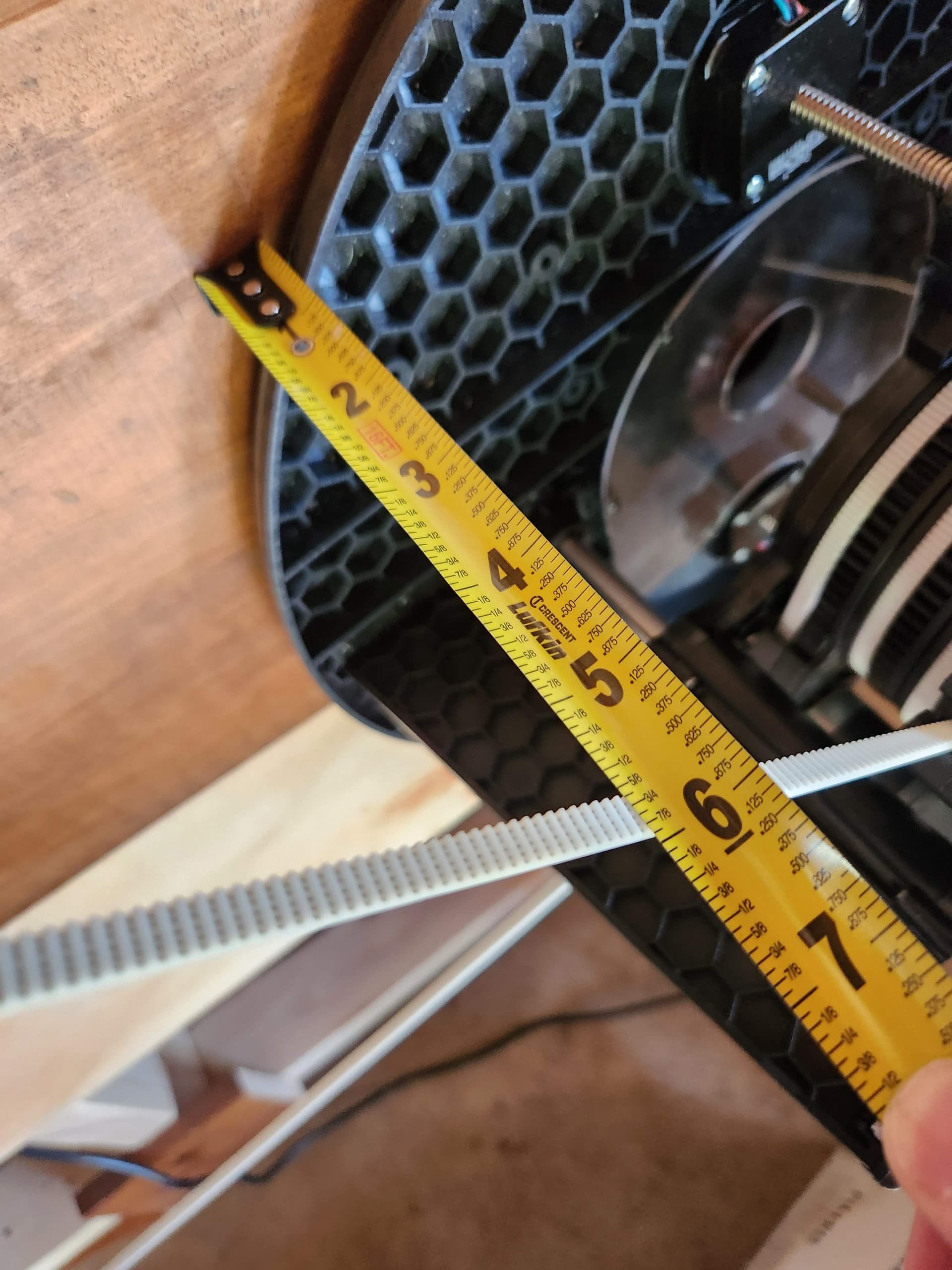

@bar it is 4.1. The belts are tight and have a steep angle. I had increase the extension by 10mm to even get them on. Which on a side note, we really need a way to manually over ride and release the tension if there is a problem. It is rather difficult to get them off when full tension is applied. I am guessing this is a safety feature to keep it from dropping. Maybe a release button that lets out a mm or so each time it is pressed.

I am thinking of putting longer bolts in with a double nut to hold the belts more in line to keep them closer to 90 degrees based on what you said

The steep angle seems somewhat concerning. How steep are we talking?

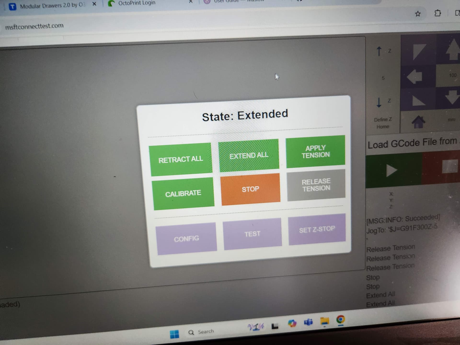

Understood but it would not do anything for me in this state. Fan didnt kick on or try to move when I pressed the button. I figured it was a fail safe of some sort.
I am really not sure. My guess is 30 to 45 degrees. It was almost at the top of the z because I had a router bit in and was doing a dry run. I could set it up and measure it this weekend if it would help.
that sounds like enough to be a problem (it will flex the arm down and add
friction making it harder for the arm to pivot)
see what you can do to raise the anchor a bit (and change the Z offset to match
what you change)

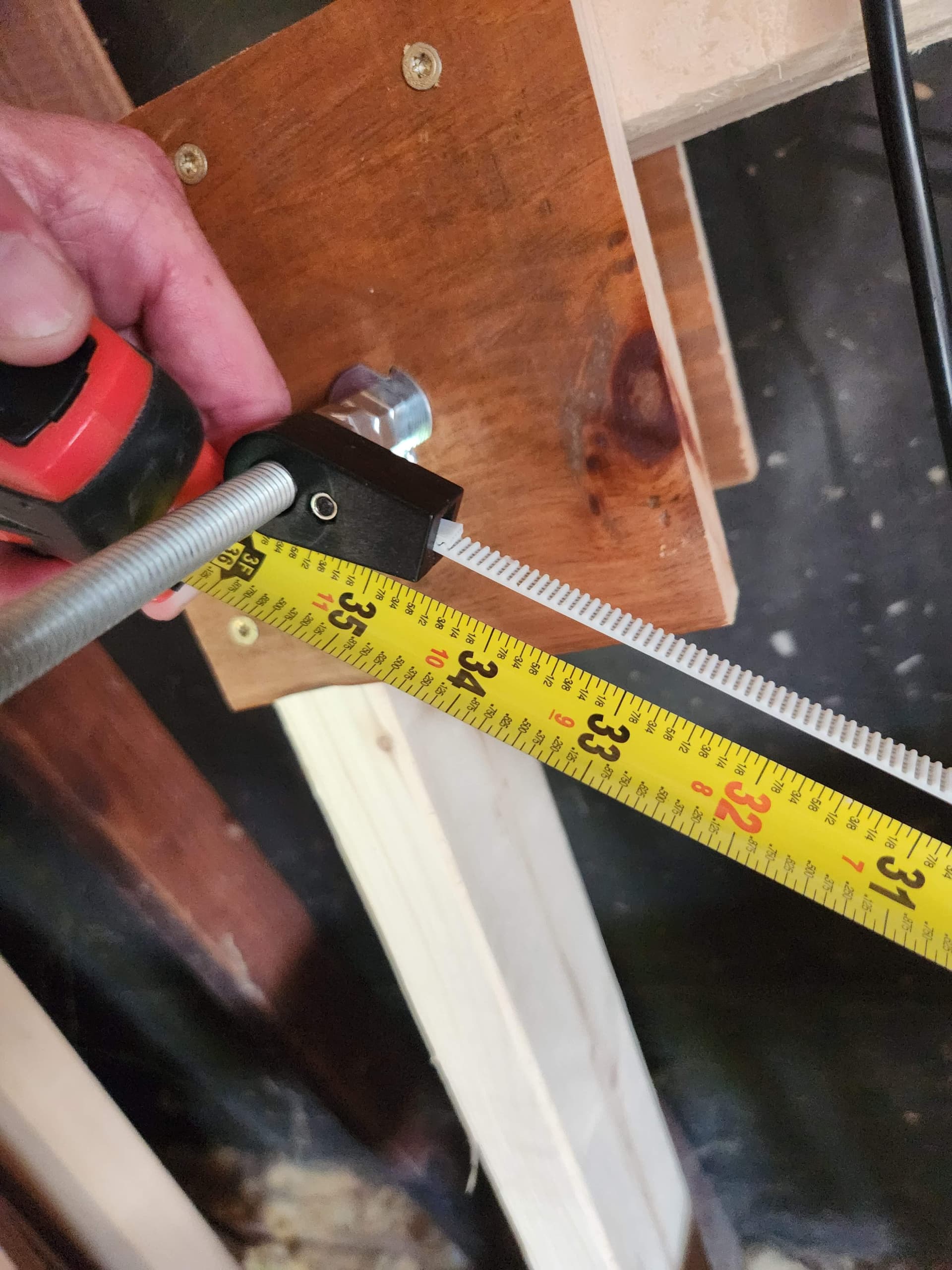

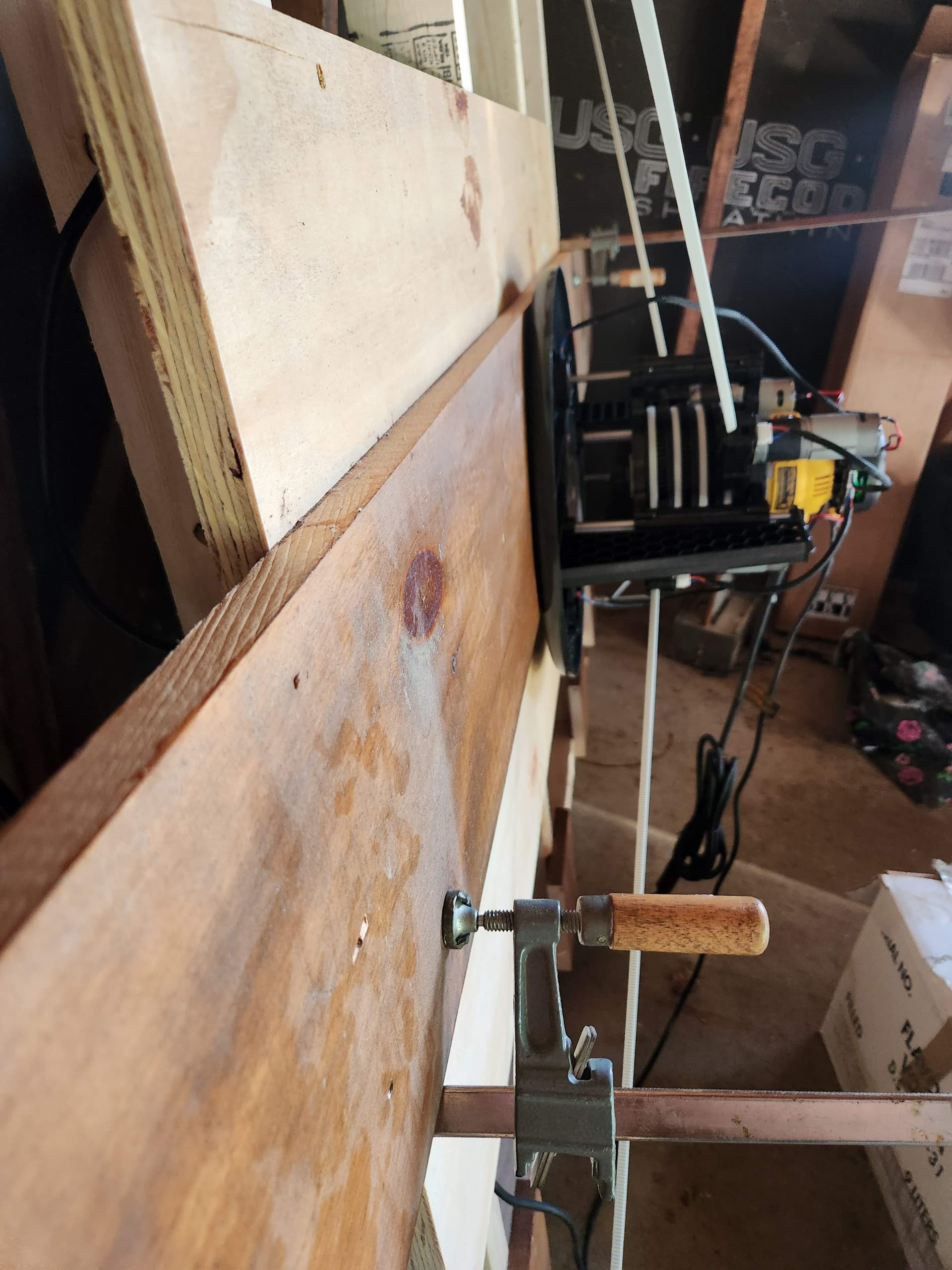

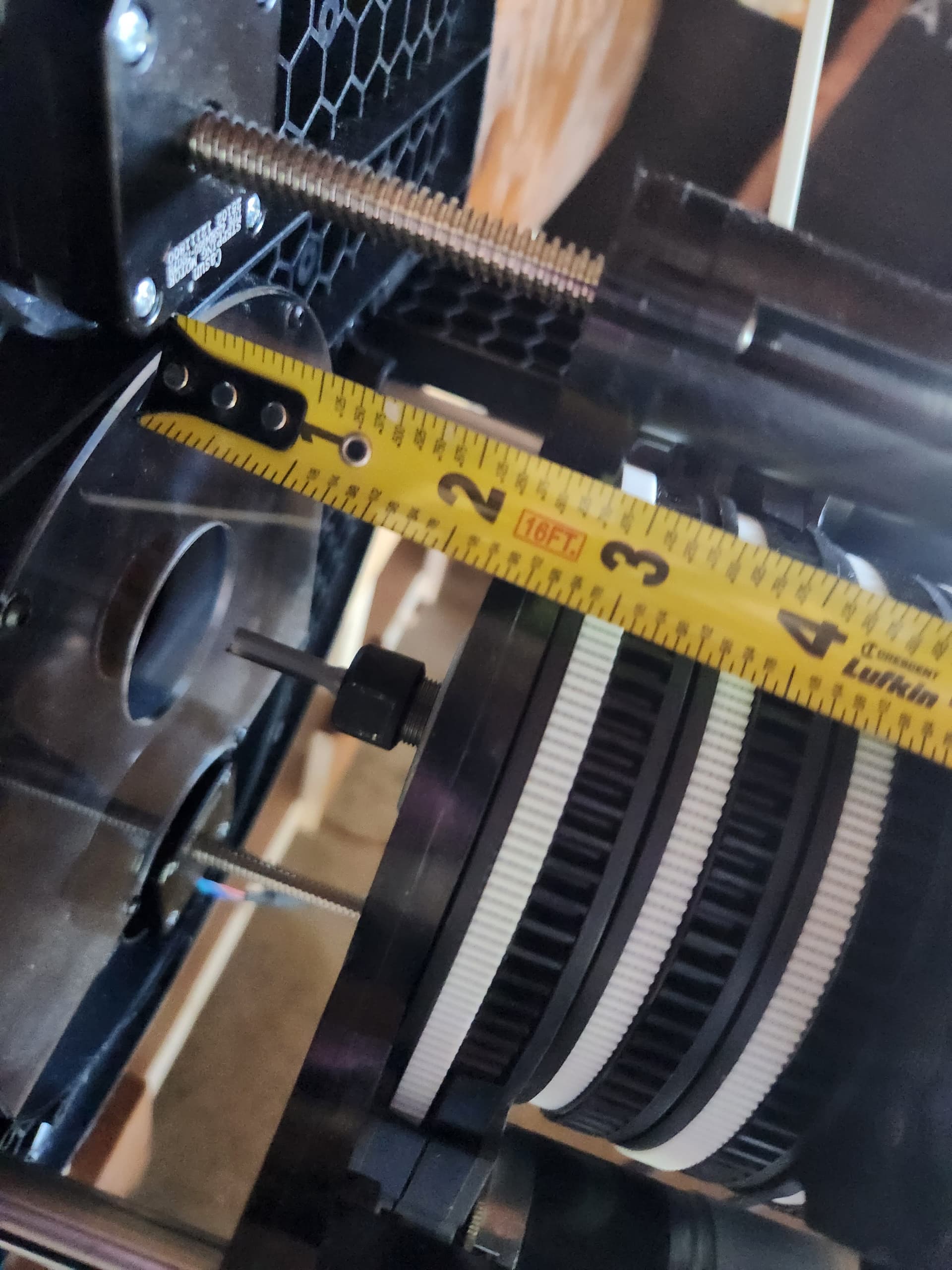

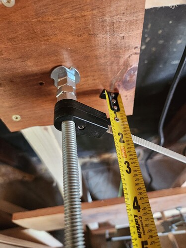

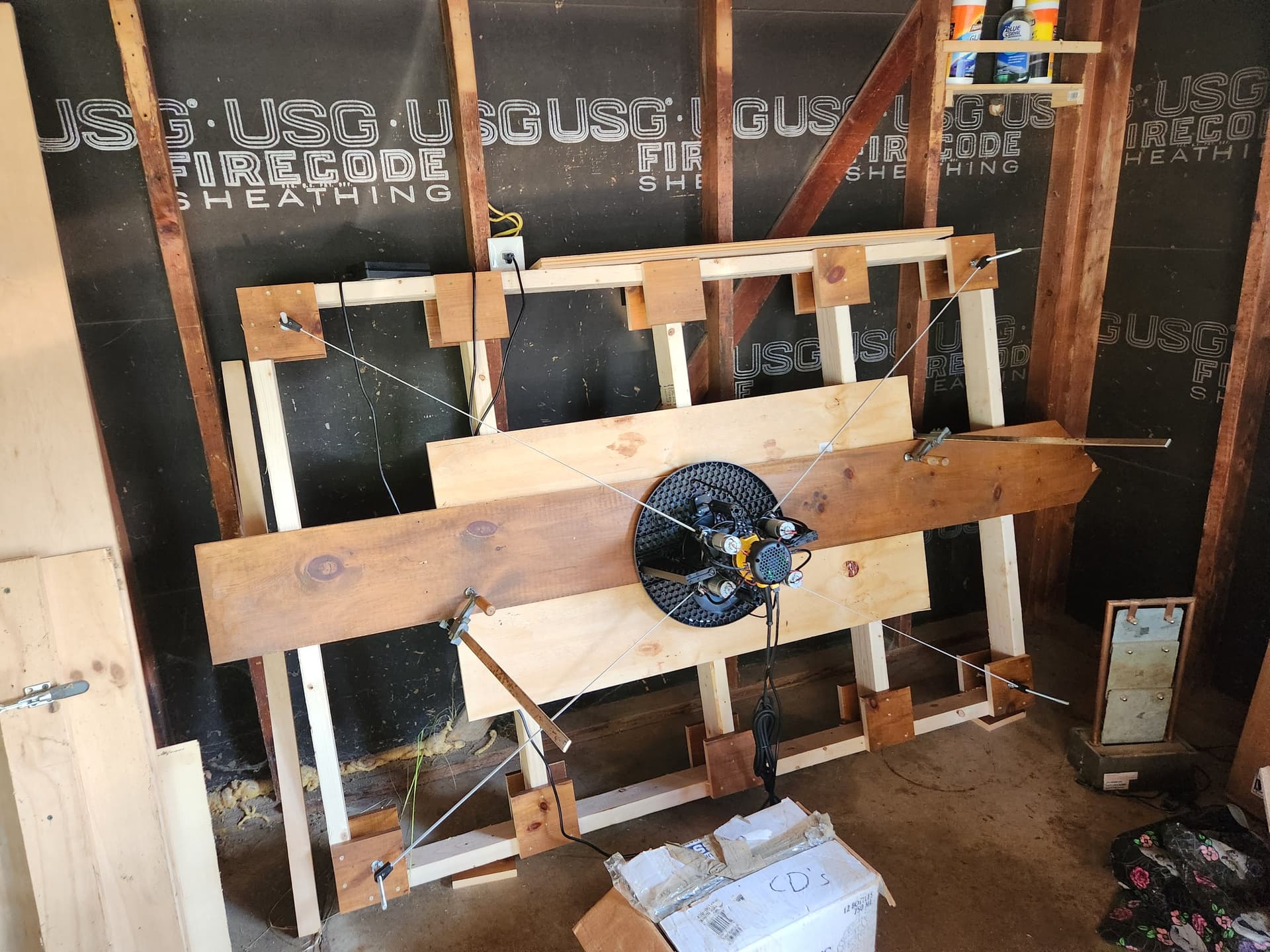

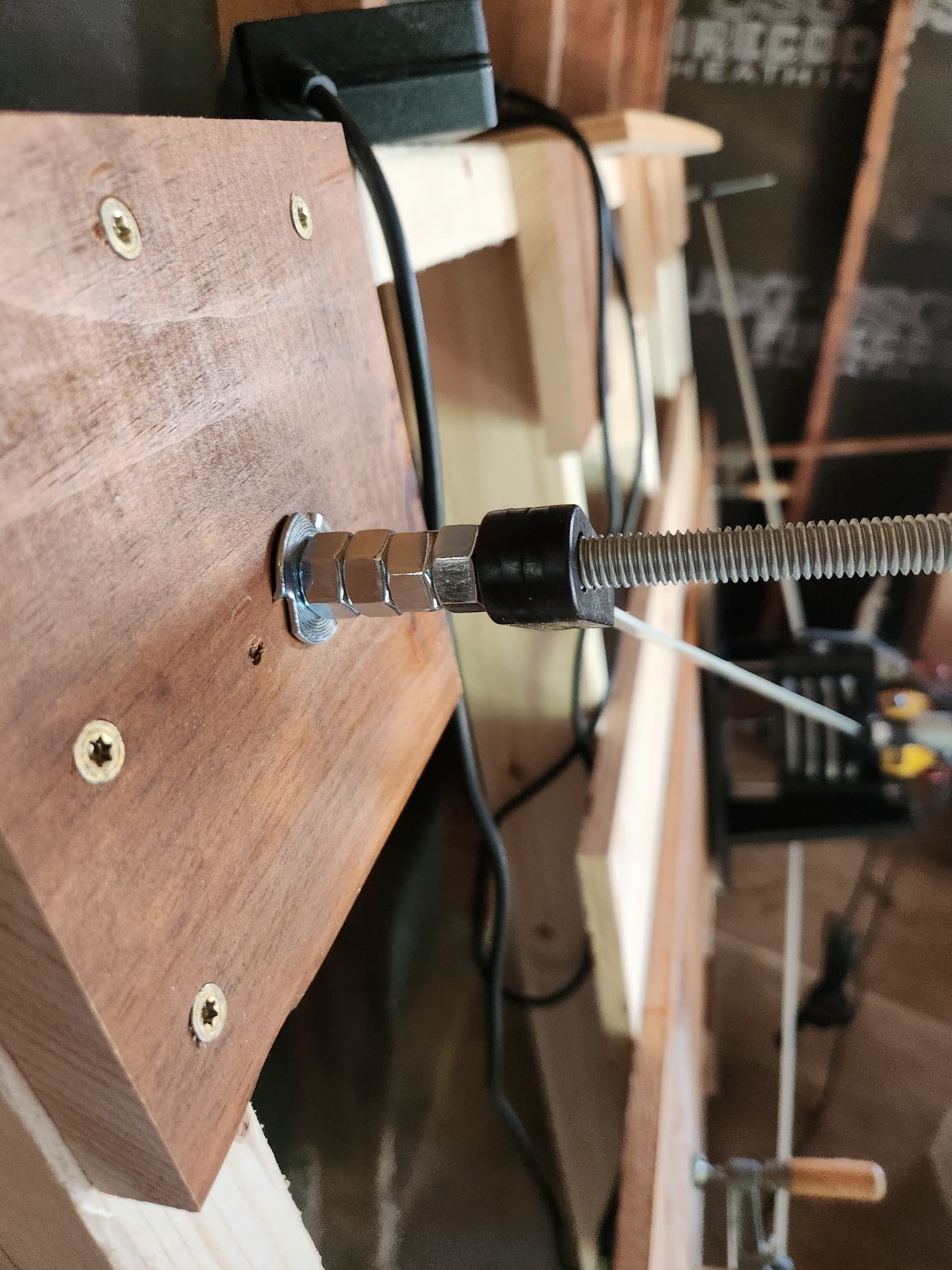

Finally getting back to this again. I am thinking my frame is just too small. See attached for a few pictures. As you can see the release button is grayed out. I am thinking of recalibrating it with the board I am trying to machine under it before making a whole new frame. Added over an inch with the nuts.

one thing is that you need a nylock nut on top of your anchor to keep it from
moving up the anchor rod.
what is the size of your frame and the size of the area you are trying to
calibrate or cut over.
here are two tools to check your size.
http://www.lang.hm/maslow/maslow4_frame.html
Sacrificial board 2 ft x 4 ft. The frame is 4 x 6. Everything looks green on the first tool. Last idea is to calibrate over the piece I am trying to cut. Its a pain when it stops like this. It is difficult to get the Maslow off the frame

take another look and enter the size in mm (1830x1220 frame and 1220x610 for
workpiece) and you will see that you go out of the green in the corners and the
top/bottom center
if you enter the values in inches, the lines are too wide and make things look
better than they are.
