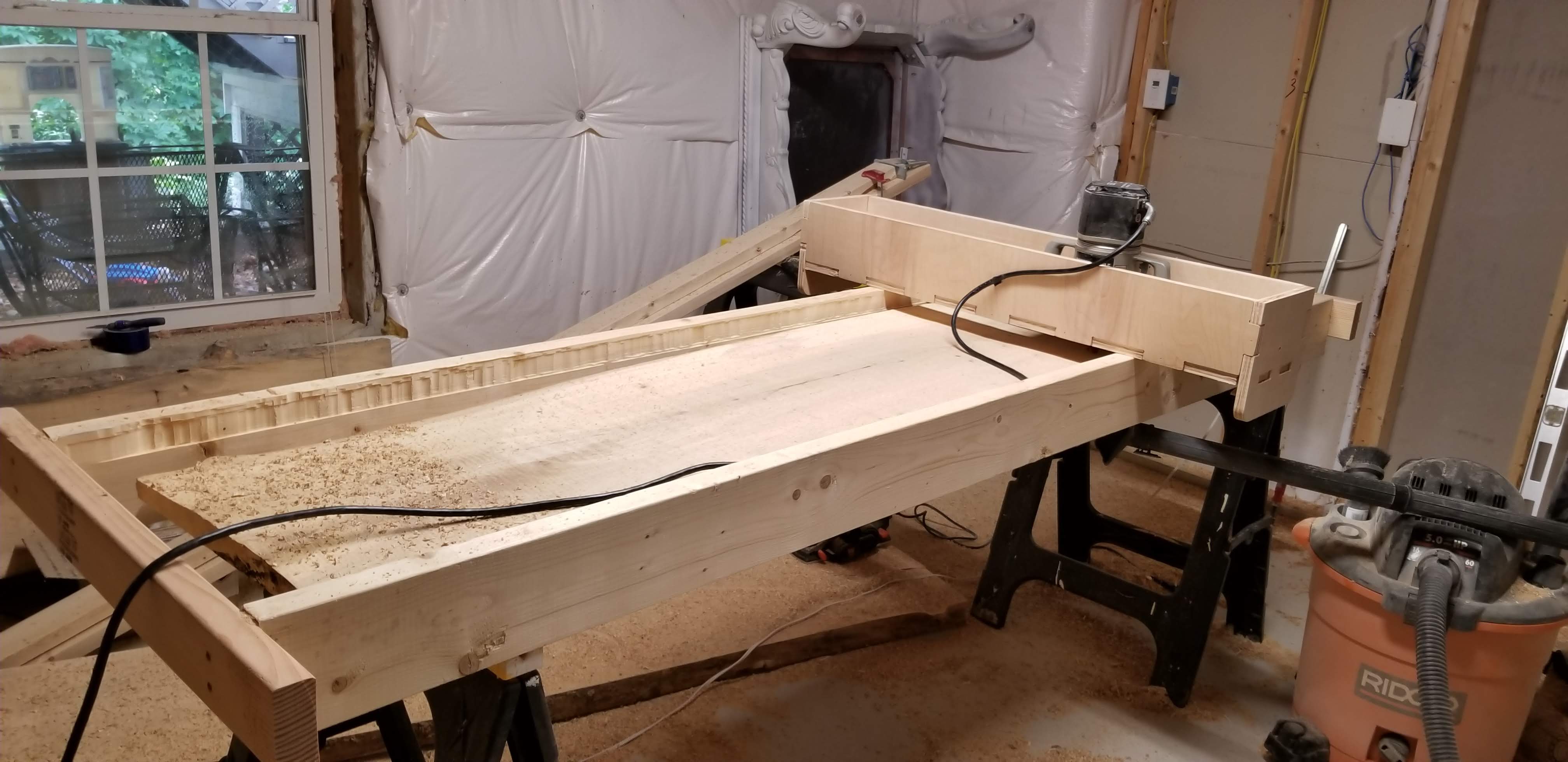

And here it is in action, resting on two 2x6 boards that sit on the sawhorses and then are screwed into the edges of the slab to stabilize everything.
As you can see, I’m using a different router than my maslow one, but this design would work with any routers that are 7" or smaller at the base, including the Rigid R22002.

(Note: The cut files work fine, but something in the g-code I generated was causing the z-axis to raise and re-lower at each depth change, but it only added a few minutes to the cut if that doesn’t bother you)
Hope this proves useful to some of you; have a great week!
