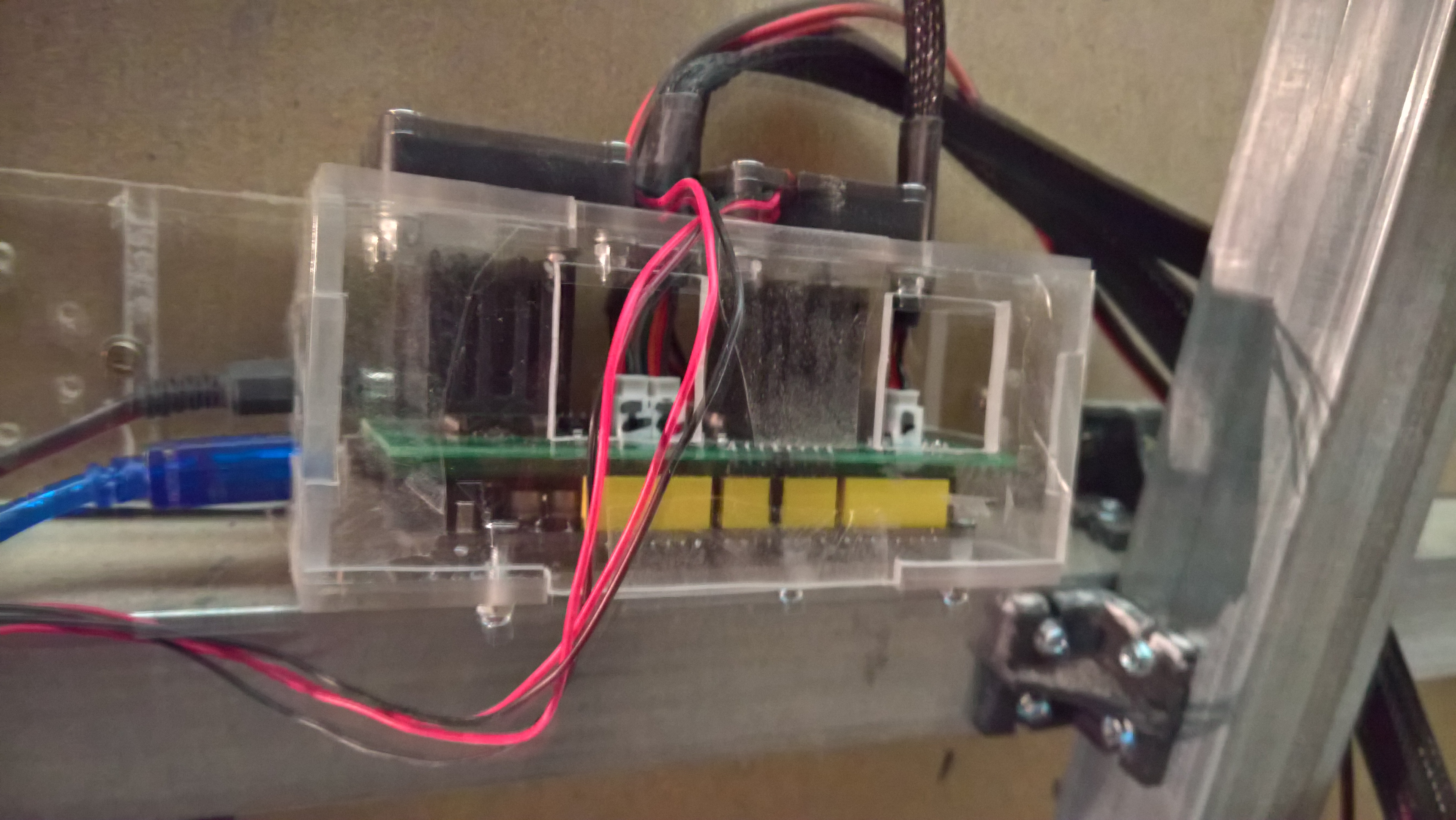

Installing the fan case with electronic.

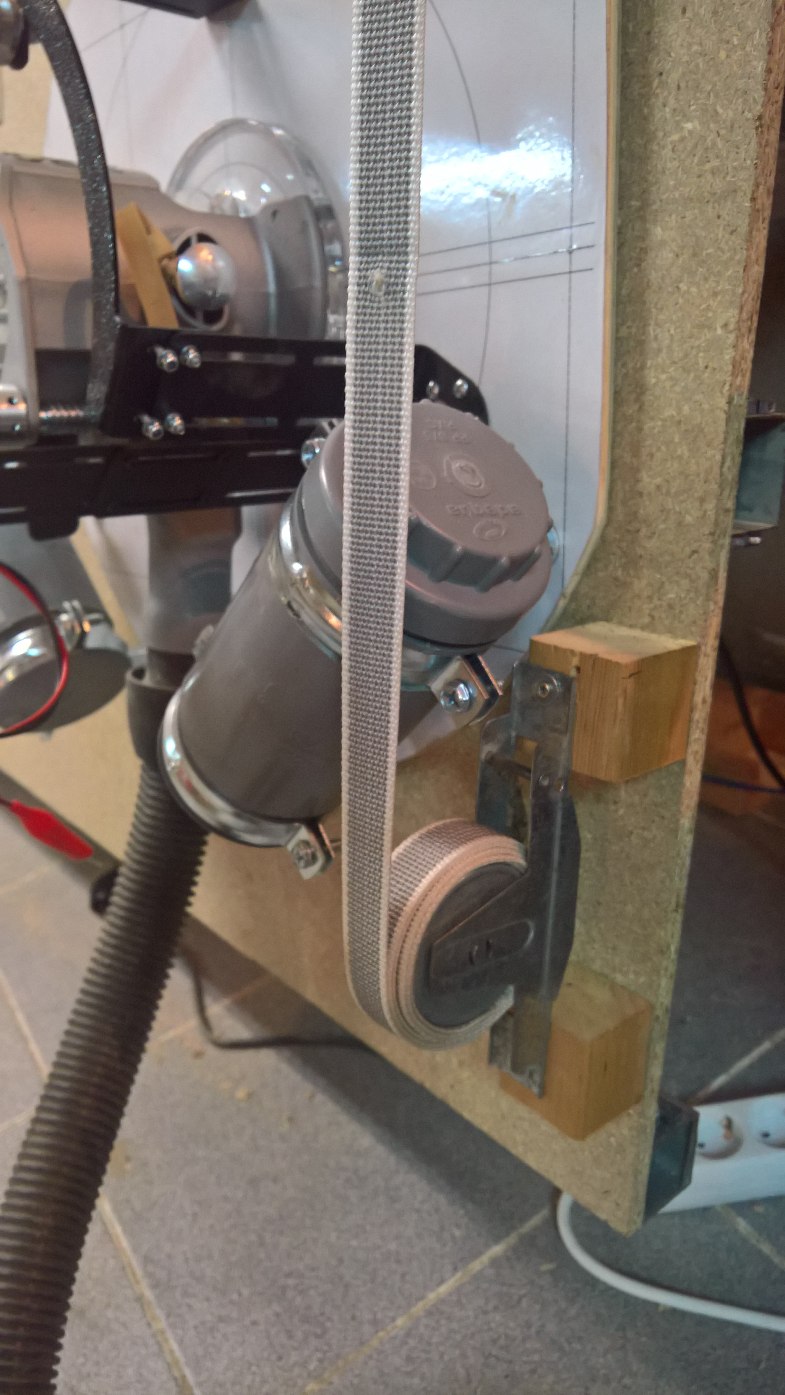

The blind roller (roller shutter), this was my first attempt. Could be posible in the future.
Is made with rolling shutter coil.

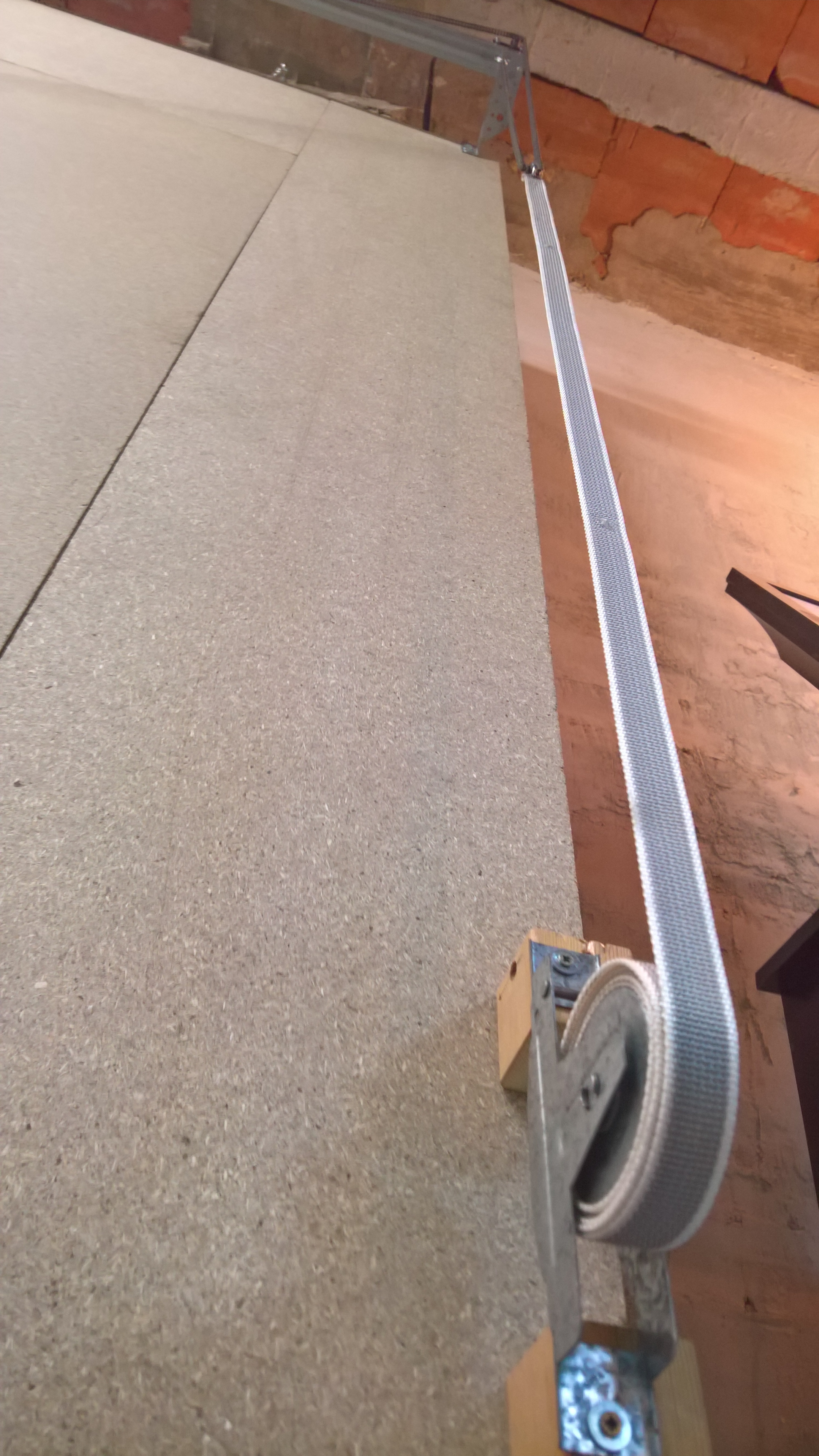

But finally i used a strap.
In the lower position.
In the upper position.

That is so great! Thank you for all the pictures and sharing your ideas! Can you please share the model information or better yet - a link to where someone could buy the blind roller? The website you linked does a great explanation of what a Constant Force Spring is, but I cannot find the blind roller or “rolling shutter coil” you showed here. Thanks again! :slight_smile:
Love it, but i would mount it horizontally across the top.
It saves you from the “trial of a thousand pulleys” :slight_smile:
@ChuckC Over here you can get them at every diy store. Something like this, this or this would work i think.
Ahhh its a neat German device, I see now! I finally found it on Ebay by searching Belt Winder lol… I will keep searching for various terms, maybe someone in the USA sells it.
@Dag83 Thank you! Yes I was thinking I could try this on our other Maslow. Hey you can get by with less pulleys if you want less precision and more friction :wink:
I just assumed they existed everywhere, don’t you have these in America? it’s part of the mechanism to open them, but these days most are electric.

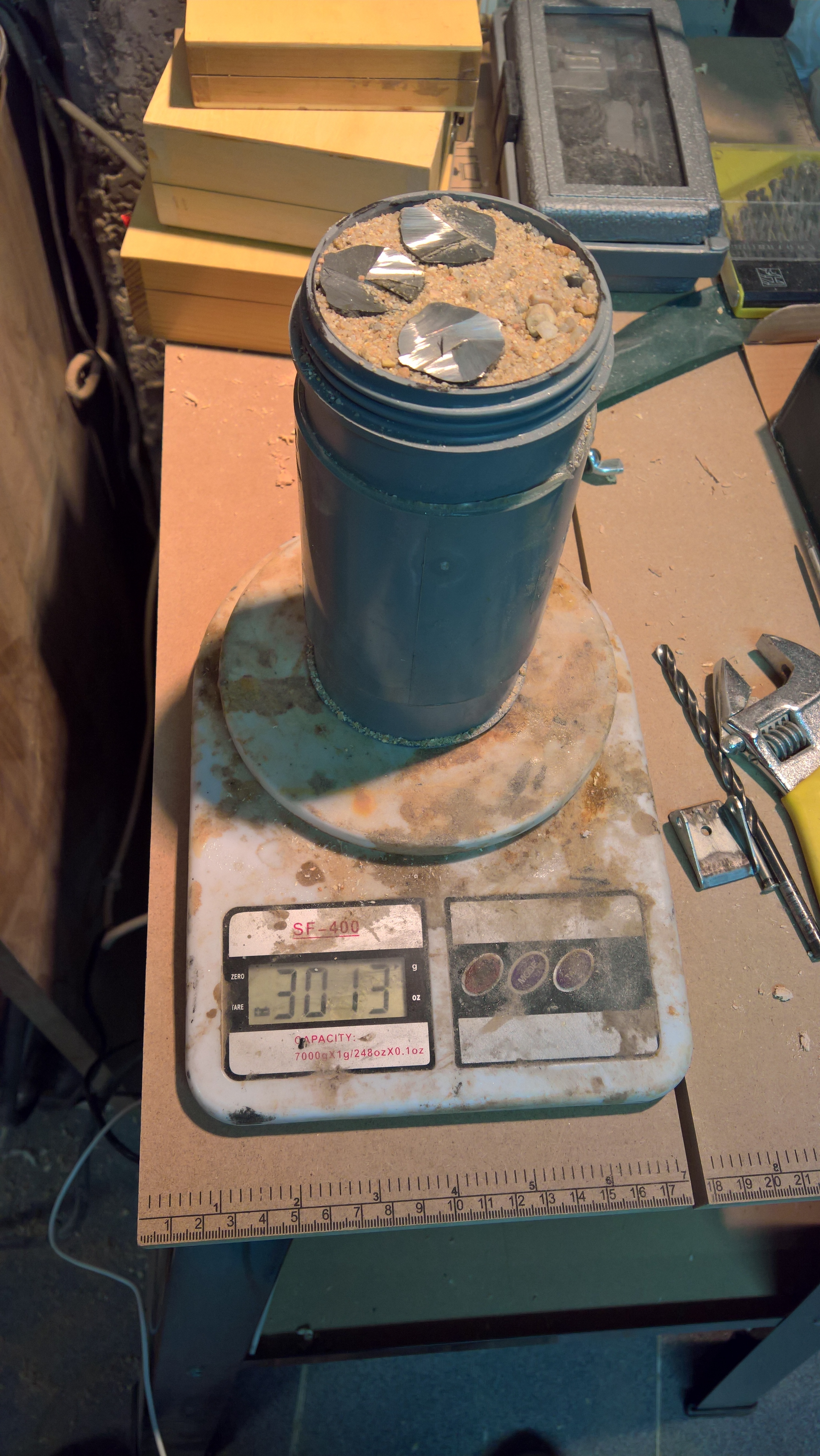

I’ve made two pases with 2 differents weights.
Only sand.
Iron and sand

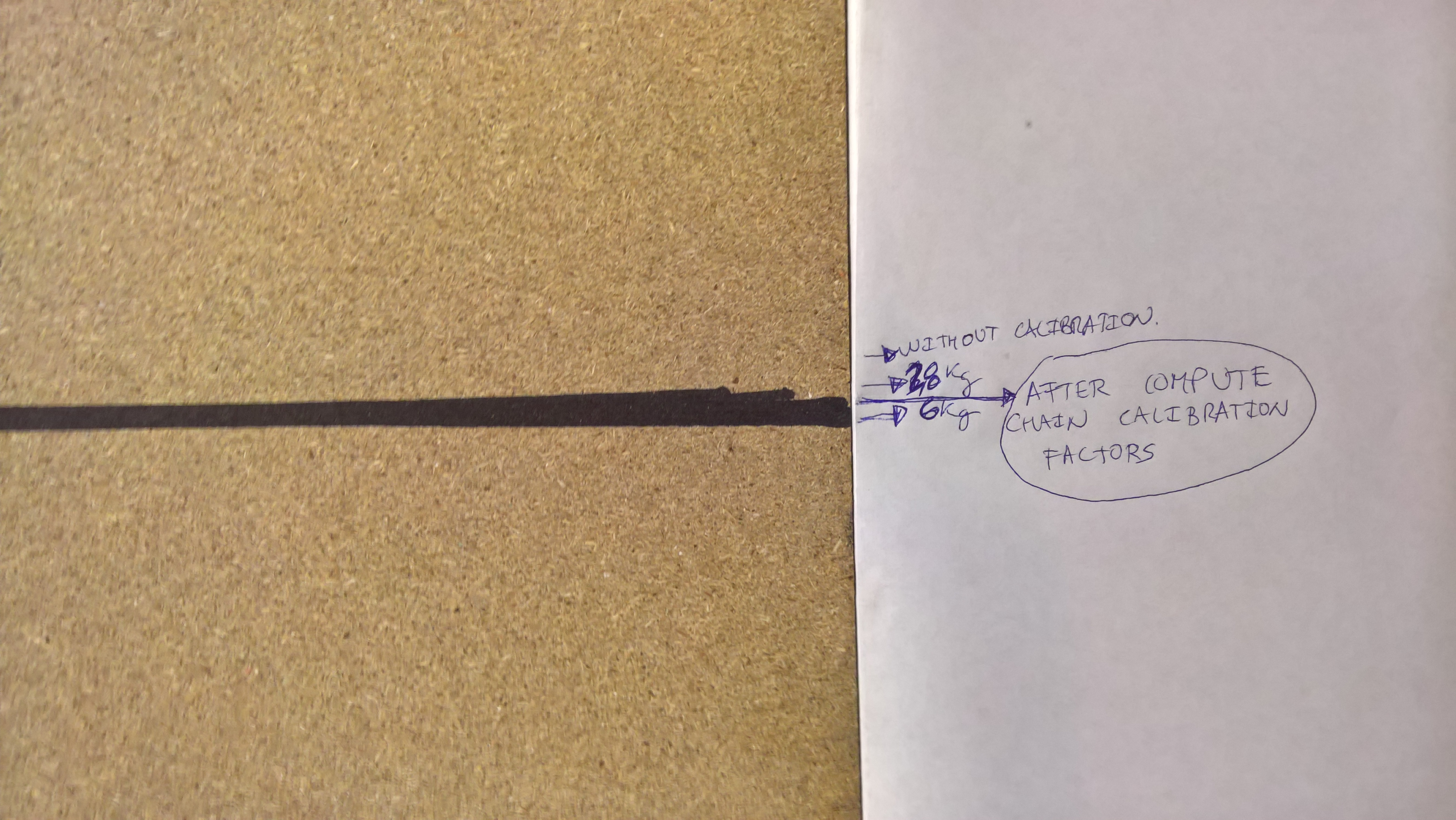

The final result in the middle right.
I’ve detected interferences
I’ve drawn the work área with this results in the corners,
one thing, the difference between the weight of the router motor and the pen
will mean that the calibration results that are right for one will not be right
for the other (chain sag compensation specifically)
It’s true, I’ll do the same operation with the router (5kg more) over the black lines.

don’t try to eliminate the chain sag, just measure it accurately in the calibration step. Then the software should correct for the sag.
On the topic of chain sag, someone was commenting somewhere that it would vary with sled weight, which in turn varies with sled configuration. I like the marker that fits in a router because it uses the router as a marker holder, meaning the sled weight should be nearly the same as with the bit.
On the other hand, two things are different: 1) no router shaft rotation, which seems like it would impart gyroscopic forces; and 2) no vibration from the bit cutting. I’d be interested to see if, running a pattern with the marker, then with a bit, they foldow the same path.
And a third, the side force from dragging the bit through the wood. In practice, I haven’t found any of the three have a big effect on plotting, but are important with the bit in the router. They are a reminder to me to use a sharp bit, conservative cutting depths and check the cutting speed and feed rate.

I’ll run a test pattern with the marker and then with a bit, but i’ve a question.
How we should measure distances accurately.
On the right to right of the cut,
on the center of the cut,
or on the right to left of the cut
All my measurements were made with laser and a block of wood located in the center of the mark.
