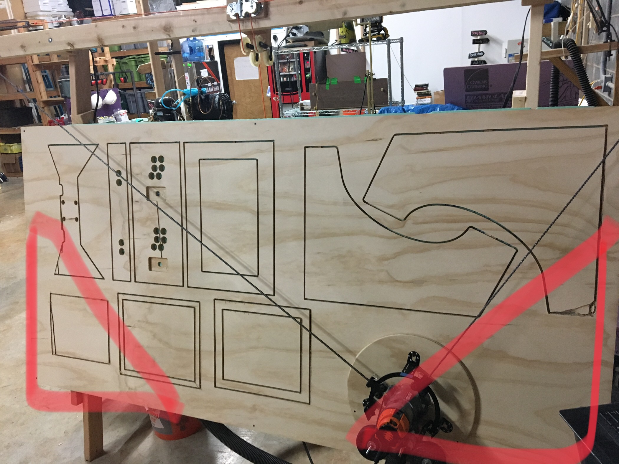

That being said, today i tried a very slow bottom corner cut at only 9 IPM (instead of usual 35) and unfortunately had same failure as two other pieces in red danger zone. Half tempted to try again at 4 IPM… any thoughts other than adding medium duty retractable lines to bottom ?

you need to reduce friction.
trying to change the cut direction would give you grief as both the cut down and the cut to the left are problems.
I would guess than in both cases (left and right) the object was being cut in a counter-clockwise pattern.
on the left you see the standard symptom of the sled sticking in a down cut (the cut wanders), on the right you see the standard symptom of the sled sticking on a cut towards the outside (the cut stops, and then ‘cuts the corner’ as the chain starts pulling the sled up)
you can sand the bottom of the sled, wax it, put a different surface on it, add weight to the sled, tilt the frame towards vertical, all of which will help in these cases
the 12’ header does not require different software, just different numbers
during the calibration step
But a longer top beam will not help the downward cut problem, only the cut
towards the outside problem.
The downward cut already has full gravity force being applied, the sled is
sticking and the chains both go slack, until the router vibration (and/or the
sled tilting away from the workpiece) jars it loose to slide down a little
futher (but because the chains are slack, you have no control over where it
goes, thus the wandering)

Is this a tension issue or a friction issue (I guess actually both).
The left side (problems cutting down) is a friction issue, both chains are
completely slack.
The right side is both, the sled is sticking, so decreasing friction would help,
but you also have very little tension of the long chain, so going to a wider top
beam would help (but not enough on a sled like this that is sticking when going
down)

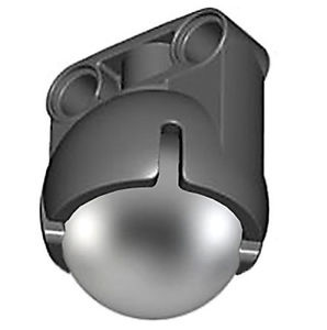

your post just had me think of roller castors to reduce friction down.
you are cutting away the material the castors would be trying to roll on, it
would be very easy to end up with even several of them dropping into a pocket
you have cut.
Several people have suggested this in the past, nobody has shown it working
(you also have the problem that they are much thicker than the sled, so you now
have to use a much longer router bit, or get much more creative in your
mounting)
