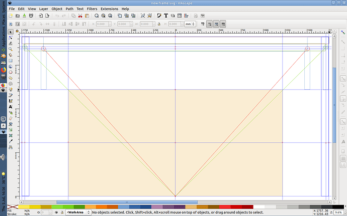

I’ve been running the Maslow for 14 months with 2x4’s that have twisted and bent. The new top beam will be rock solid. For the dimensions I’m going more symmetric with the new build. I’ll just go a little up and pretty much wider (as wide as I can before toughing the walls.) Would love to see same math.
Old motor position red, new green.
Edit: If I’m not wrong, it will be near the max stretch with the stock chains.
