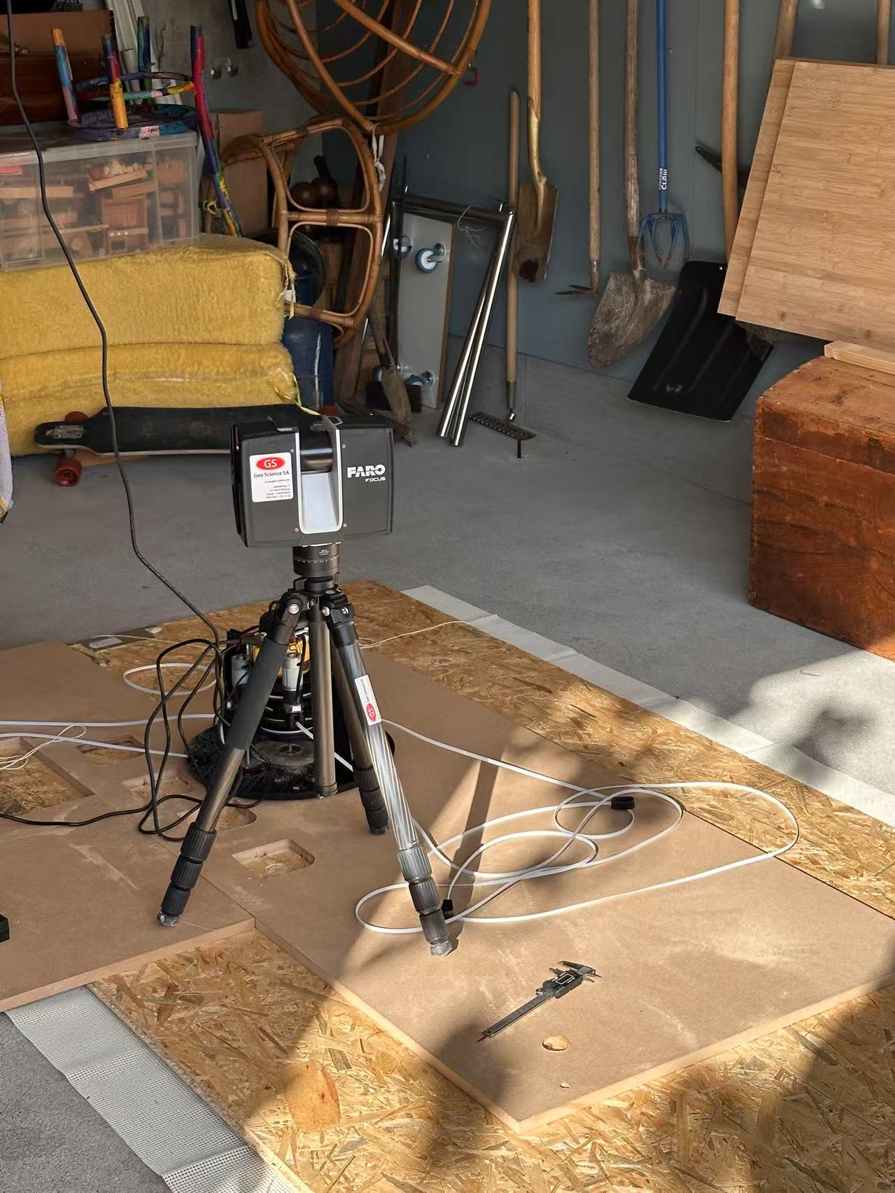

I recently started cutting with my Maslow 4.1 and have managed to dial in the cutting parameters pretty well. The repeatability of my cuts is better than 1mm, which I’m happy with so far. However, I’m seeing a systematic error of about 5mm in the Y-direction — even when cutting near the center of the workspace.
Back during initial setup, I ran into issues with the calibration procedure and read that manual calibration can be a viable alternative in cases like this. So I decided to go the precision route:
I made custom anchors with 10mm H7 bores, and cemented them into the garage floor for long-term stability. My goal here was to ensure the frame size remains accurate over time. I then measured my anchor points using a Faro laser scanner, with an expected accuracy of ±1mm.
I’ve just started comparing the software calibration with my actual scanned measurements. That said, I made a small mistake: I forgot to lower the Z-axis to the bottom before running the calibration, which may have influenced the results.
I’m currently on a business trip and won’t be able to re-run the calibration or cut parts until next week. But in the meantime, I’d appreciate any input:
Should I adjust the tlz, trz, blz, brz values manually?
My anchor points are flush with the floor, and I’m using a 22mm thick spoil board.

Oh, and about that Faro scanner: Get rid of it. Throw it my way. (Okay, I admit I’m just a little bit jealous … I can’t even count how often during my home renovation I wished I had such a tool!!!)

It was your post that motivated me to take accurate measurements of my anchor positions. This weekend I’ll have a bit of time to test things out and compare the measured positions against the automatic calibration – I’m really curious to see how much of a difference it makes.
Unfortunately, the Faro scanner isn’t mine – it belongs to a friend who does scanning and design work for renovations professionally. Luckily for me, the scan only cost a few beers and a BBQ

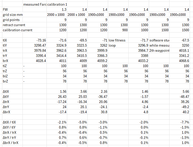

I finally had the chance to run a quick comparison between the automatic calibration and the Faro measurement data. While it’s just a single repetition per test, the initial results are interesting.
What stood out: lower calibration threshold currents appear to yield better accuracy. Specifically, with a threshold current of 1000, the results were very close to the Faro measurements.
Just to make sure I’m reading this correctly, that would be this data here, right?
Yes, that’s right. The data isn’t exactly reading-friendly at first glance. But here’s how to make sense of it:
  • The leftmost column shows the scanner measurement, which serves as reference.
  • The next columns are calibration runs with different parameters.
  • At the bottom of each column, is the difference between the calibration and the reference measurement.
