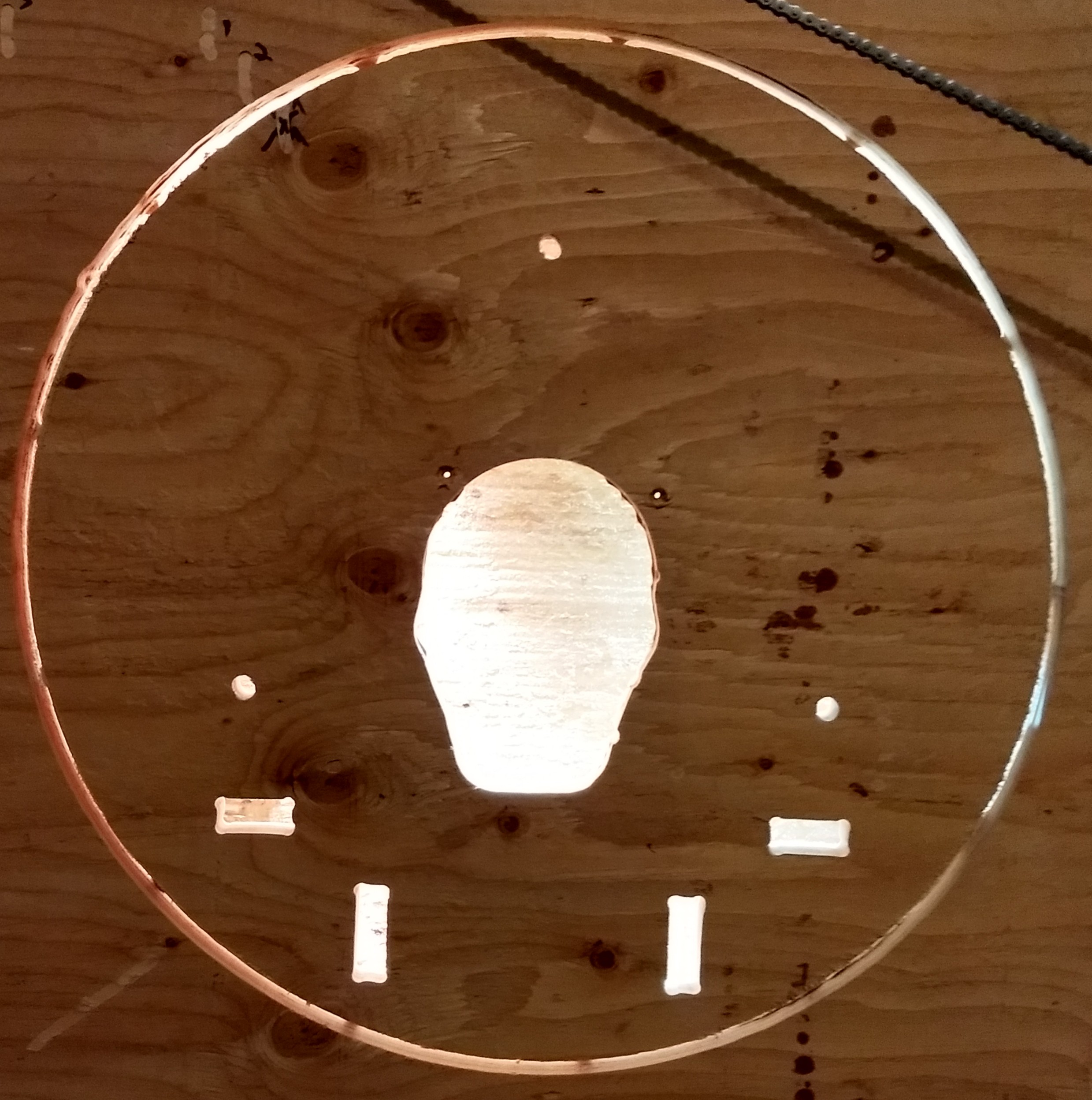

I did get my sled cut which I think was the biggest obstacle to getting the new Z axis built. The baby-sitting wasnā€™t too bad but I should think about a dwell after each z-move.
The tab strategy worked pretty well but I put two screws (chicken fasteners?) in because I was skeptical about the z moves.
