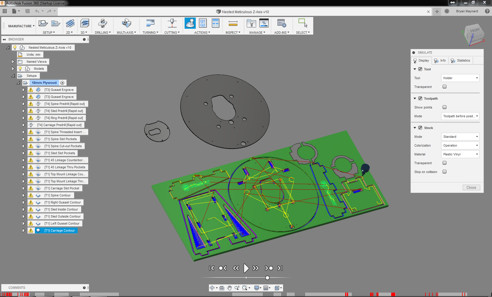

I’ve been talking a lot about updates lately, and while I’m not ready to publish NC files to the Garden, I have enough progress that I can make my nested Fusion files available.
So far I just have the 18mm plywood for the main version programmed. I would like to test a couple new CAM features I’m using before posting and releasing nc files. As of now, these are untested programs, so be cautious running them.
I have not programmed the 0.250" HPDE sled skid pad, or the 0.125" acyrlic dust chute for the main version. I also have not even started on the plywood version. I do want to make them available so that people can work off of the Fusion files until I finish doing the NC files.
Nested Main File: https://a360.co/2KUE4Hc
Nested Plywood Version: https://a360.co/2VhulyW
