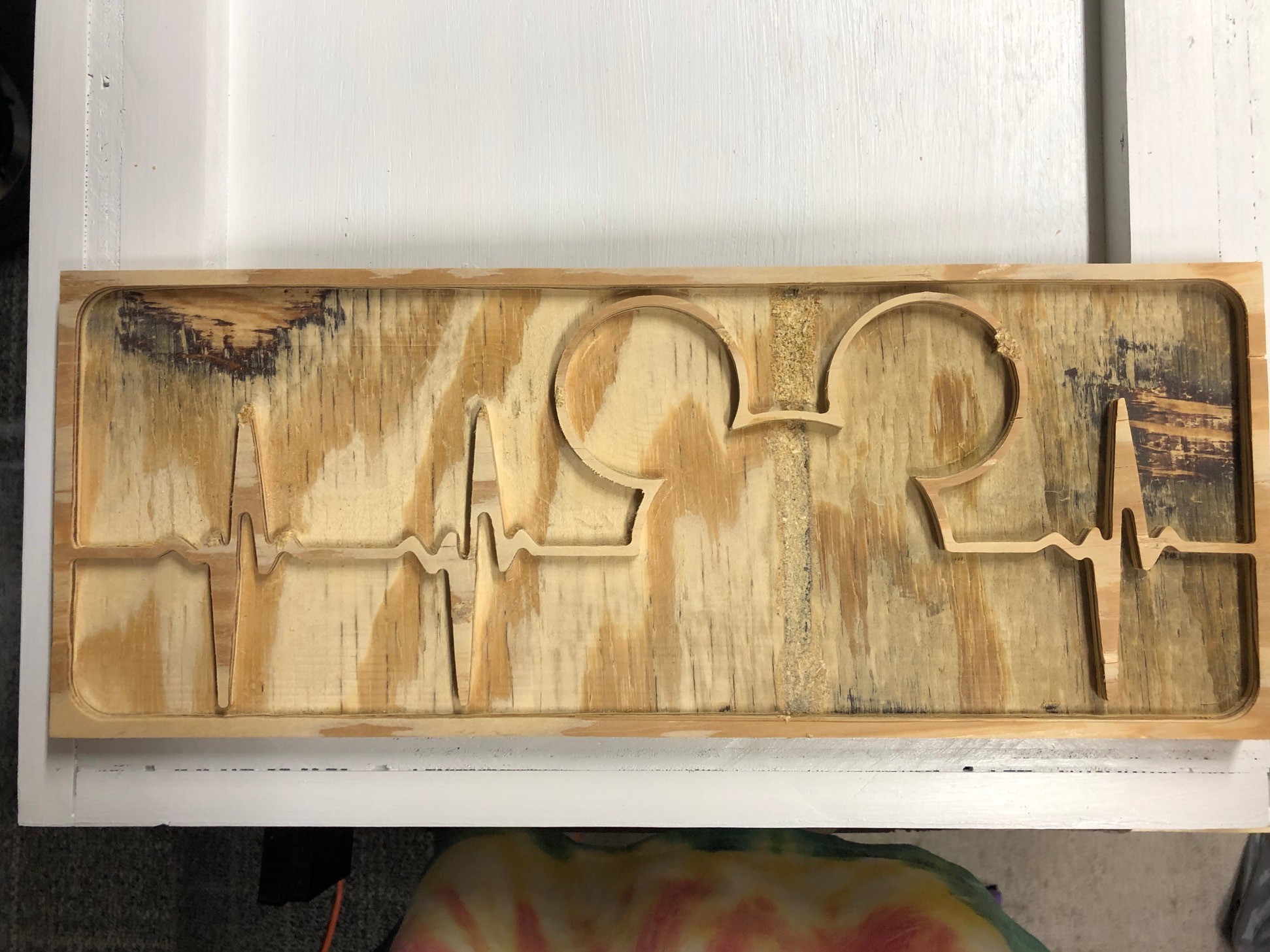

So my first cut, and it turned out ok. Only took 7 hours to cut on a second try (the first one was about 75% complete when I lost my z-axis due to the set screws on the coupler falling out. I found one on the floor and had to did through my ShopVac bag to find the other. Some locktite the next day and I was back in business so really 14 hours total work time), and I have some fixes to do (mostly because of the ply and how thin the design ended up being). I plan on painting it all white, and then using a lime green tinted epoxy to fill the pocket. I’ll post more once it is complete.
