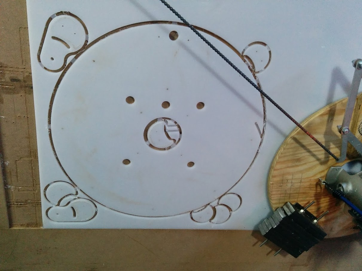

I messed up my sheet of HDPE for the bottom by accident… its usable but has a line cut in it. So i’m probably gonna have to get another sheet. just dumb mistakes when i picked the place to start from with my malsow.
I know, right? I would have found another supplier if I knew the shipping was going to be astronomical. And also needed to go to a loading dock, not my little apartment.
I also had a problem cutting my HDPE and the bit drifted into the part. I caught it, but not before there was a sizable gouge where it shouldn’t be. I just put it on anyways, thinking I would cut another at some point. I am still using the same one, I haven’t had any trouble with it so I haven’t made a new one yet.
