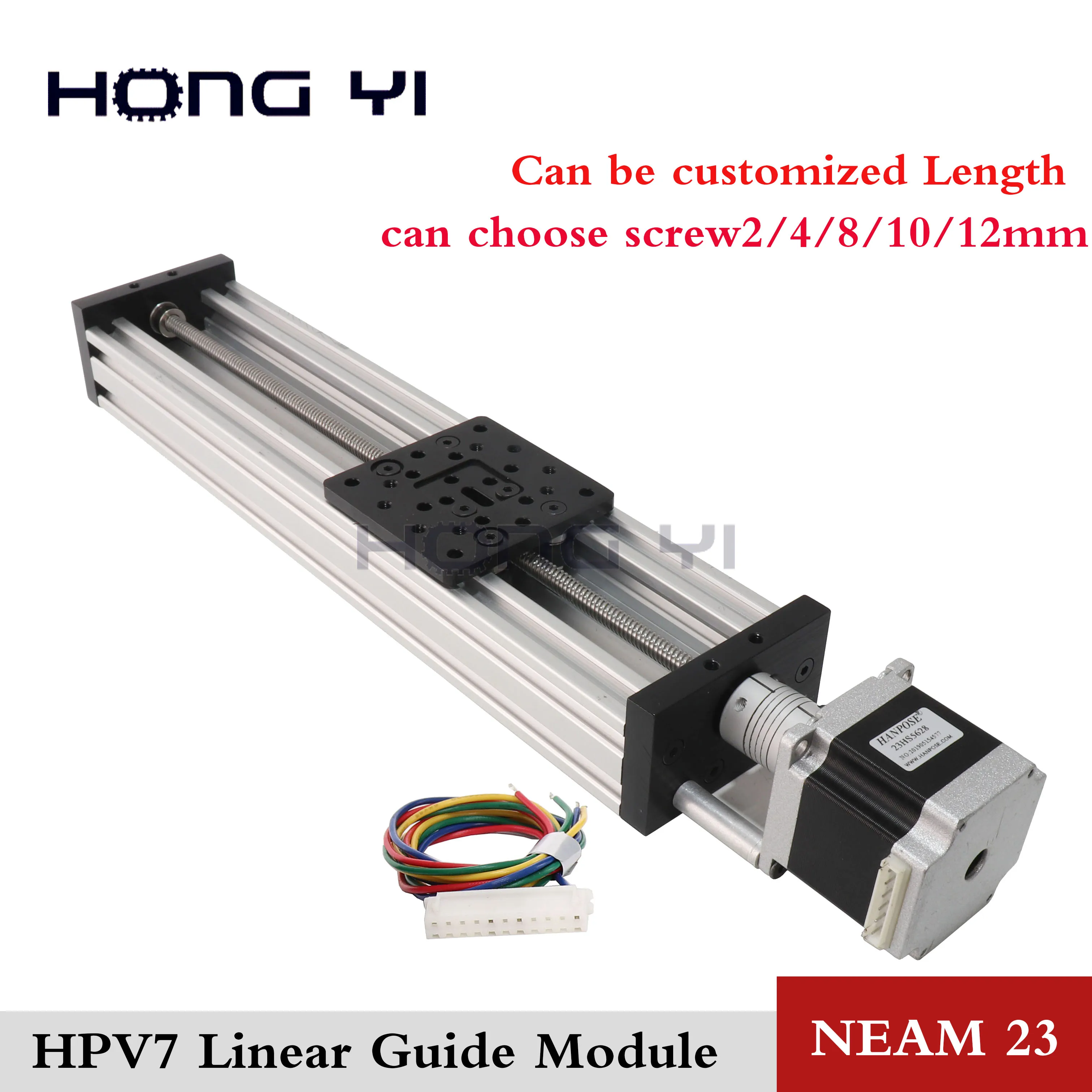

If someone was going to hypothetically design a controller for testing but include a stepper motor controller for z-axis, is there any ‘preferred’ stepper motor module? I see them readily available all over the internet.
To clarify further, my thought was perhaps a controller with components for five DC motors and headers installed if someone wants to install an optional stepper motor module and use it for the Z-axis.
I would use the standard plugable module
see the wide variety in the first list at
These are all pin compatible [1] and most new driver chips get packaged into
this format so that they can be used with a bunch of 3d printer boards.
[1] some of them have options for serial or SPI interfaces to the boards for
enhanced features, such as detecting when it has hit it’s limit without switches
I am leaning in the stepper for the zaxis direction too, especially since linear slides can be had cheaply with a stepper motor already attached. I don’t have any recommendations, but I am excited to see the results.
One possibility is that the same chip could be used to power a DC motor option if needed. A stepper motor is basically two DC motors in one.
Can someone briefly explain the advantage of a stepper motor?
main advantage is availability, one can buy them almost everywhere. supposedly they are cheaper, but we are talking about maybe saving $5 when bought in bulk.
You can get a linear slide with a stepper motor mounted to it cheaply. People have mounted DC motors to them, but it doesn’t bolt right up… I think @MeticulousMaynard’s zaxis uses a belt or something between the motor and the linear slide… as an example.
That would be possible if we use a chaip that’s a pair of H-bridges, but if we
use one of the off-the-shelf stepper drivers, they don’t support that mode of
operation. And the small stepper drivers are so cheap (<$1 in quantity from
china) that it’s hard to justify the cost and complexity (both in software and
hardware) to support this.
steppers are used on almost all 3d printers, so if you can use the particular
size steppers that they use, they are really cheap (I got 5 for $25),
Also, because of the 3D printer and desktop CNC markets, there are a lot of Z
axis setups ready made that have the screw holes to mount a stepper (if they
don’t include the stepper as well) an example being $37 (free shipping) for
