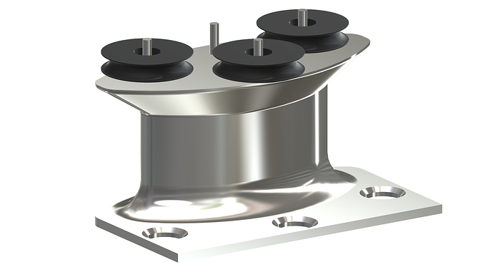

Just off the top of my head. the pin in the middle out front the chain would slide over and be held in ( Just like the Pulley wheels ) with a nut. There would be bearings between shafts and the pulley wheels.
It could be way more simple. Just wanted to bang the concept out quickly. The hoop would ride pinched between the three pulley wheels.
I think nylon pulley wheels could be gotten for way less than stainless V wheels.
you are horribly over-engineering this
forces are only in one direction (tension on the chain), and so if you go with multiple points of contact with the ring, you just add uncertainly and error (exactly what is the distance from the end of the chain to the center of the ring?)

Well yeah it’s over engineered, but three points of contact eliminate ALL slop. and it could easily be done with plate and angle or tube. trust me the first one wouldn’t look like that. It would be junkyard fabulous.

Takes a littel work and you have to do the math for spacing to get your desired radius, but can be done with just two wheels. Three would be easiest though…

Everyone seems to be instinctively adding at least two points of contact, and I think that is the right idea. I’ve noticed that all of the similar things that I can find out there use at least two wheels like these zip line trolleys:https://zipline.systems/index.php/zip-line-pulleys-trolleys.html
I think it’s because with just one point of contact there is a tenancy for the block to pivot in place and until a bit of strain builds up, then suddenly catch up with where it should be. A second point of contact would prevent that pivoting in place. That’s just a hunch, but I certainly am seeing behavior where the block waits until some strain has built up, then catches up suddenly.
That leads me to point #2. I know nobody has proposed using a block without bearings, but we need real bearings. All the blocks available at the local hardware stores rely on the bronze wheel sliding on a steel pin, which has almost exactly the same coefficient of friction as the bronze wheel sliding on the steel rod so sometimes the block won’t even rotate, just slide which isn’t any good.
