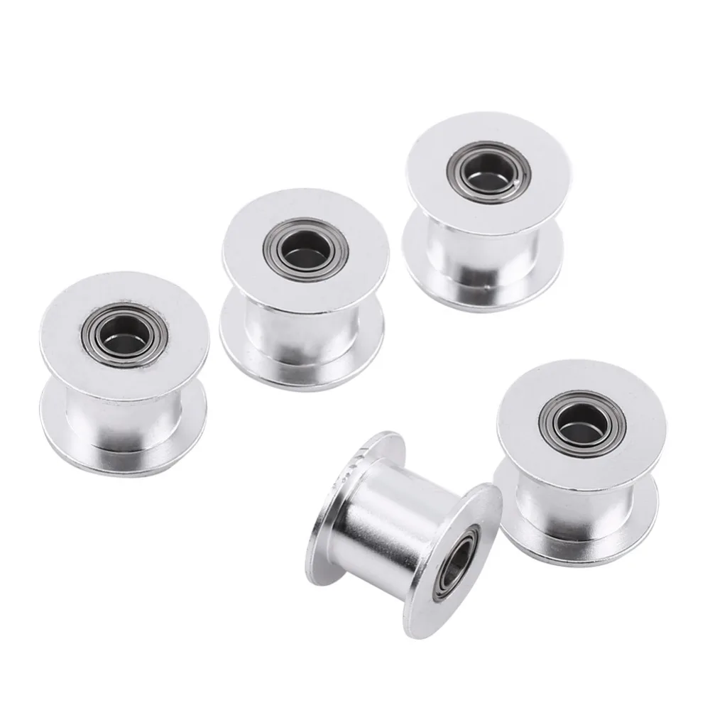

If you use a plastic channel to have the chain inside… like this one…
2 channels going over the length of the top bar(if needed)… hiding the chain and the stretchy string…
Using the nylon chain guide to guide the chain into the channel.or something like this…
