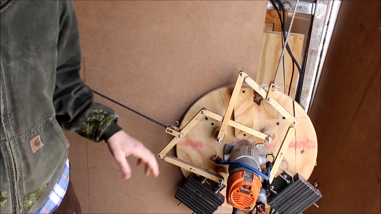

I also encountered an issue with the linkages when the chains get close to vertical. Once it gets past a certain piont, the linkage bars slip on each other and throw off the cut.
TopMount_LinkageSlip
This may simply have been because my top beam is shorter than most, so chain is more vertical than it would be with a “stock” top beam. It started happening on the outer two rows of squares, I would have to work within 600mm (~24") of the centerline of the bed to avoid this issue. However, I was able to cut out to this area with no trouble with the 45 degree linkage kit, so I believe the system works more reliably across the entire bed.

for the linkage to fold like it did, one of three things has to have happened
  1. the center holes are just slightly too close to each other (easy to check by
    comparing their distance with the holes in the verticals)
  2. the bolts flexed slightly (temporarily making them too close to each other)
  3. the slop in the holes give just enough play for them to clear
The first two are taken care of by the new center piece (I just ordered another
run of kits and ordered a bunch of extra center pieces, so if it just turns out
to be the first two, I can start retrofitting the people who have this first
version of the kit)
if it’s the third, the new kit should do much better.
While I’m disappointed at the poor showing, I’m very happy you tested it
when you get the new kit, can you try just using the center support with the old
linkage first? that way we can tell how good we can get if I just send the new
center supports out to everyone, and then test the new kit and see what it’s
accuracy ends up as.

I saw it once or twice before, but it was usually under extreme circumstances. I thought it was just me doing something dumb. This is happening regularly now.
One other difference between before and now may also be the HDPE pad on the bottom of the sled. It’s possible that the earlier plywood sled had enough friction that the sled couldn’t rotate to a position where the jumping could occur. Just a thought, I’ve been wrong before.
That could entirely be the case. When I first set up the top mount, my plywood risers were almost flush to the bottom of the linkages. In the test, I used 1" long derlin spacers to make sure I had enough clearance for the bolts on the backside of the linkages. This does mean that the bolts have more play than they did before.
I will try to use spacers much more similar to what I used with the 45 mount. For that, I cut two 3/4" plywood circles, with a hole drilled on center sized to the bolts, the other with a hole on center sized to the derlin spacer. That way, the derlin spacer has more support and is less likely to flex under operating conditions. Also, that should help make the results a little more consistent.

I’m suggesting two things
first, add a nut (doesn’t even need to be a nylock nut, it can be a slim ‘jam nut’ which may fit on the thread), where you show it, without the plywood spacer support that you show. See what happens (you don’t need to do calibration, just see how easy it is to get the linkage to ‘snap’
second, go back to the original all-plywood riser/spacer approach, just make the top layer be 3/4" wide (you may still have to notch it slightly to let the washers clear). NoDerlin spacer involved at all
for this, make the ‘edge’ of the plywood that you are testing be about 1’ in from the motor to replicate what happens on normal machines.
Thanks for your testing
Sorry for the delay in responding to you. I was reminded of the linkage slip in @Gero’s troubleshooting thread.
I tried to do this first, but I didn’t have enough thread on the bolts to make it work. I might be able to give it a try with threaded rod, but…
This worked as a solution to the issue. I took one of my old plywood risers and ripped it to 3/4" wide to make sure that there was enough clearance for the bolts. Where the previous setup would jump at about 610mm (~24") from the centerline of the machine, now it slips at 1000mm+ (~40"+). And where it does slip, it no longer seems like the bolts aren’t aligned well as much as I’m reaching the limit of travel of the mechanism:
I also was able to test this. I took a video, but I don’t have my camera with me right now to post the resulting video. I will try and post that tonight when I have access to the video and my editing software.
I would recommend a skirt around the edge of the sheet though. At about 1’ in from the edge of the machine, I had pretty good stability. I have a 4’x8’x3/4" sheet of MDF as my spoilboard, so I effectively do have a skirt for the edges of my machine. When I jogged the machine over to the edge of the sheet, however, things got harrier. With the bit at the edge of the sheet, the sled was webble-wobbling quite a bit. I think having a skirt that is a similar thickness will improve stability greatly.
Again, I’ll post the video tonight when I get the chance so you can see better.

I hate to disappoint, so here’s the video:
My chains mount about 2 5/8" from the bottom face of the sled, or the part that contacts the work surface. I think that, given the top-heavy nature of the rigid base, the CoG is above the plane the chains are in. I really, really need to make time to add in a unistrut top beam. That would help immensely as far as keeping the chains above the CoG.
The distance between motors in Ground Control is 2761mm (108.701in). That makes sense because my top beam is 112" long. By your math, that means that the red hatched areas below are where that will happen on my bed, given my top beam length:
So on a stock frame, where there is roughly 120" between motors, this won’t happen. If you’re weird like me, don’t expect to get 96" at the bottom of the machine. I always knew I’d be giving up usable bed with my short frame.
