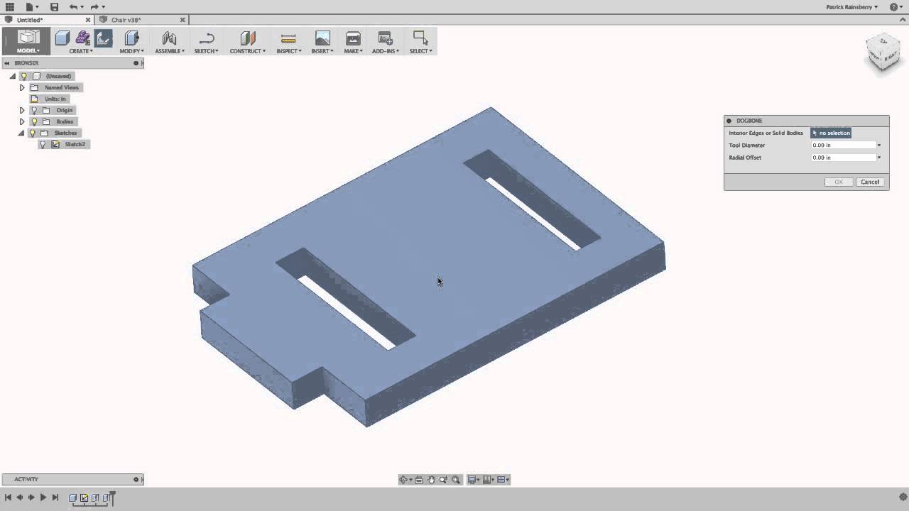

On a side note, I noticed as soon as I laid everything out that I didn’t dogbone my tabs. I was able to fix it quite easily with the dogbone plug in. If you’re not familiar with it and you model in Fusion, this is a really useful tool! It’s much, much faster than drawing all of them manually. I highly recommend checking it out:
