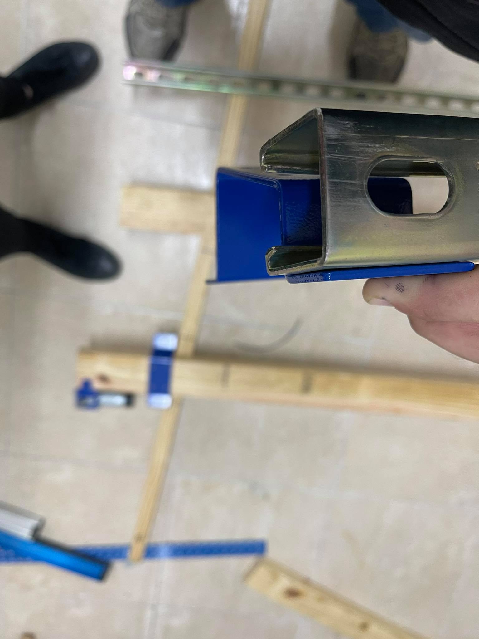

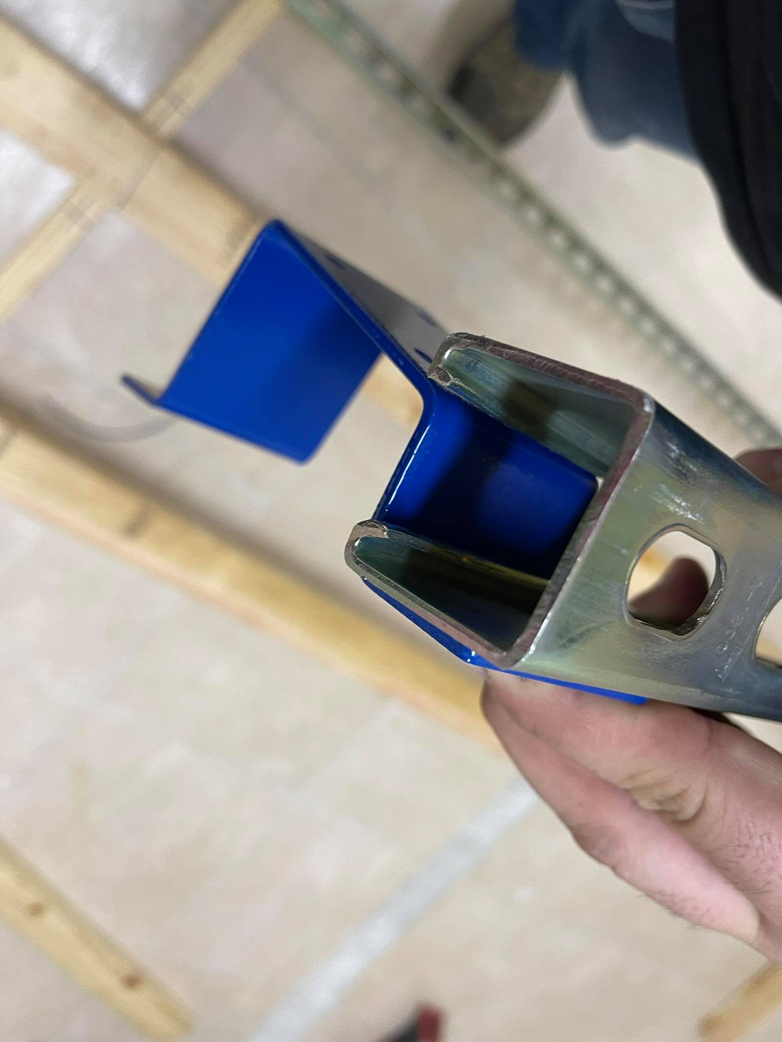

hello first of all, thanks for your help. so we bought the unistrut to mount on the top of the 2x4 wood bars. On top of the wood bar the unistrut is too thick can we use the other side?
I don’t know what those blue parts are that you are showing, but as long as the pull of the chain will not collapse the unistrut, it’s just as strong in one direction as the other.
these are the bar beams that you said to mount the Unistrut on top … i can mount on front also on both beams and move the base forward so it will be parallels?
