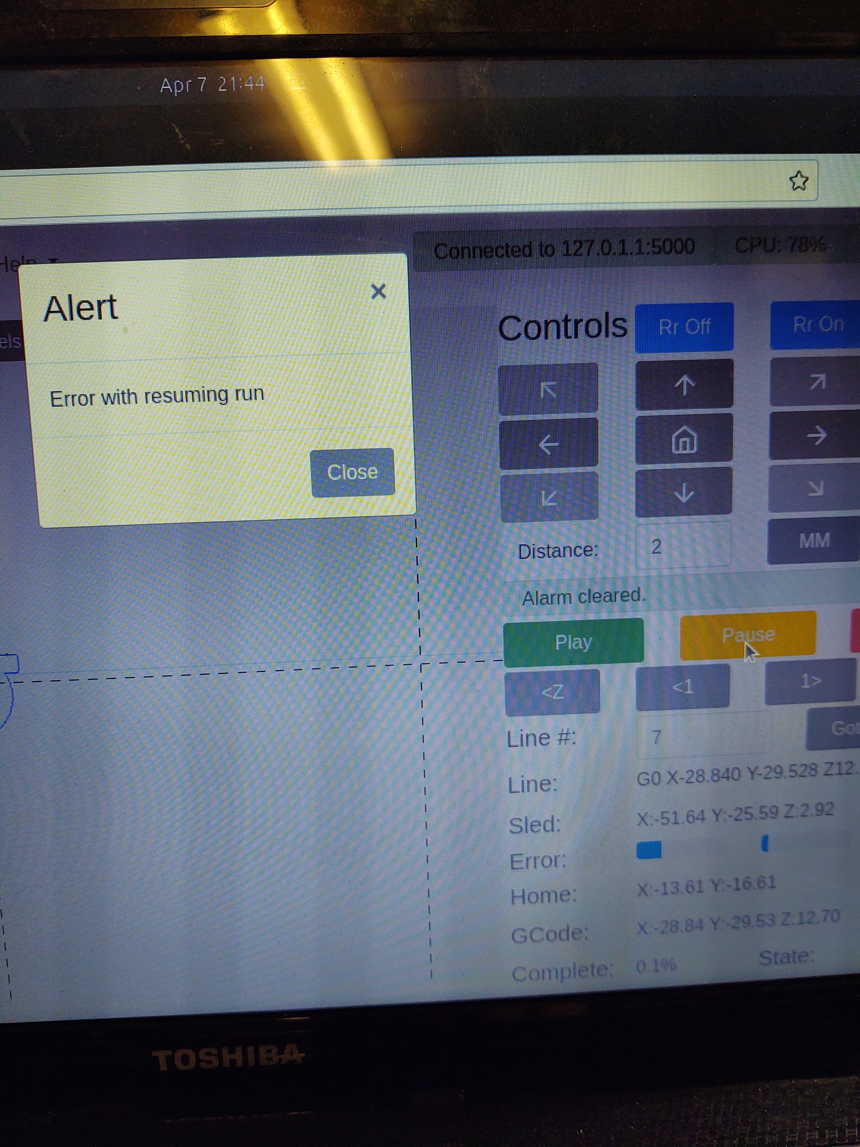

When starting an aircut. It first pauses per code and when I resume it does resume but gives me and error code.

I get that error code on resume still.
Most of the time it loads with the “V:NaN/NaN” shown in picture. When it loaded like this the gcode and sled positions don’t change although the maslow seems to be moving and following the program correctly.

  2. I’m unclear on the V: code in the window. V:NaN/NaN is “not a number” code so it is getting text.
    Edit: can you share your gcode that you are getting this error from?
