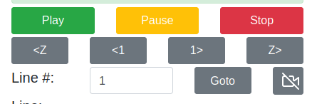

Webcontrol already has the go to line number, go to next line and go to next Z axis move with these buttons:
then just press play to resume from that line.
Yep - those I know - but sometimes you lose track of where you want things to resume from, being able to ‘dial it in’ literally by having the sled move to where it would be for a certain line would be very handy.
The other thing is that you might not know what the depth of cut is for a particular line. If resuming from a particular line is that replayed (because I don’t believe it is)?
So you want to step through the file and have it tell you what the location and depth will be at that line? Then you want it to be able to move there and then start processing from that point?
EDIT: I wonder if a z-move delay might be a good option… move the sled, but put the z axis at travel height, step through the gcode file line by line moving the sled, but not the z axis… then engage the z axis to the correct height before starting the cut from the current location after the z axis is in its proper place. That will require intercepting the z axis commands and removing them from being sent to the controller and keeping only the last one. Still thinking on how best to do that…
