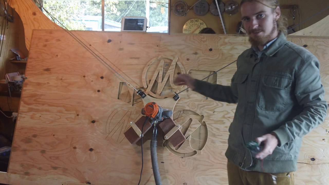

Here’s the video I made about the design process before the kickstarter and if you look around 2:18 you can see a low KV brushless motor. I don’t think the 1:8 reduction that I was proposing would have ever worked and it could be back driven which would be a big issue, but that’s why I never actually built it and went with an all in one motor
