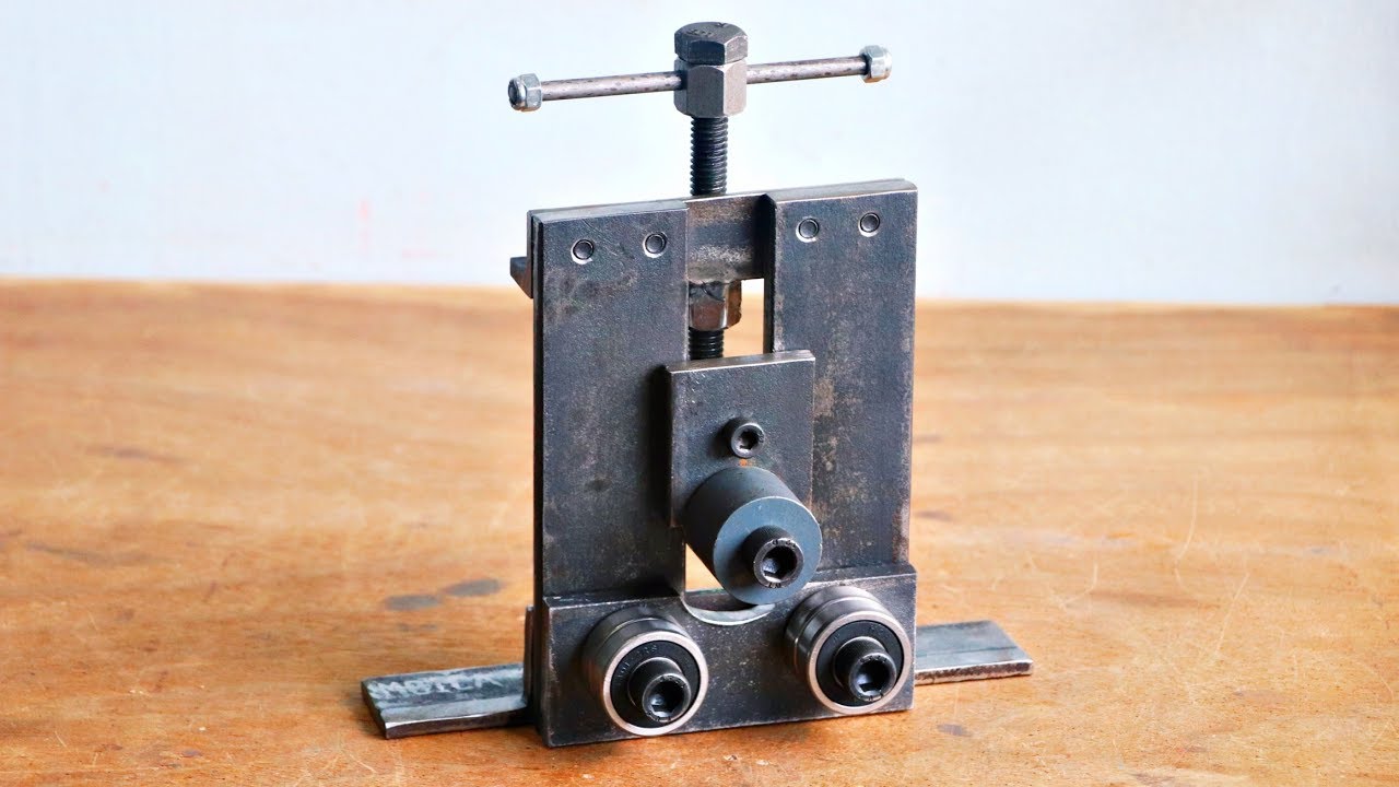

I was planing to make somthing like this:
But I went in shop they had metal bender. 8$ for material with bending to ring (it must be soft steel, otherwise it will tear and act like spring).
Then i drilled 4mm holes in places where CNC ring have mounting points.
I don’t have money to buy cnc ring :stuck_out_tongue:
