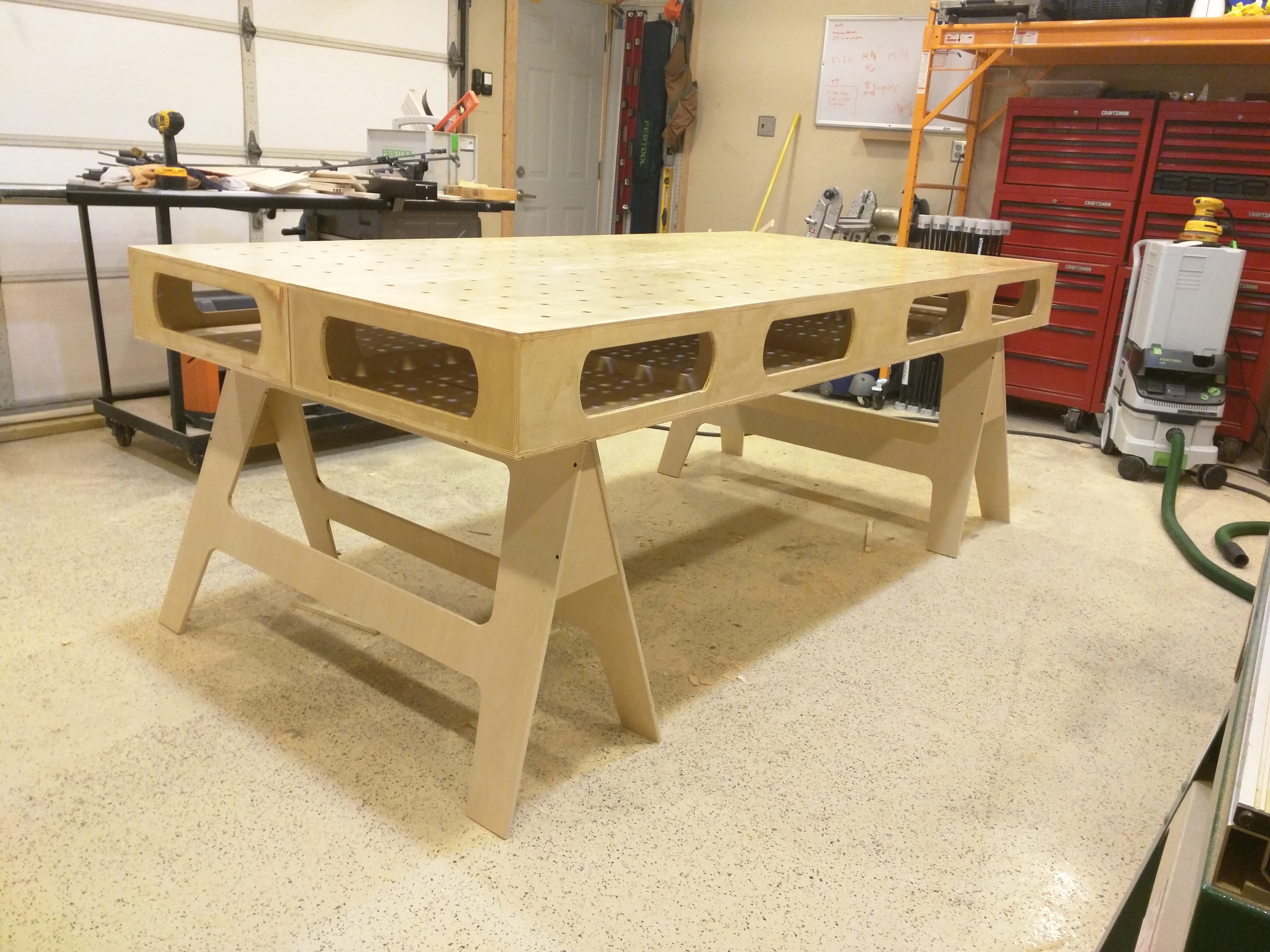

I am planning on building my frame with a bed inspired by the Paulk work bench. outlined here
I am still waiting to get my kit so I think I will build it using traditional woodworking techniques. I plan to create a jig to cut the hole pattern to ensure accuracy. Once I get to know the Maslow it will interesting to see if it can accurately tackle a full sheet plus pattern.
His newer version has a chopsaw and router table station. That is the one I built.

I actually built one of these, i’ve stood on it with my girlfriend, and it didn’t bend at all. Haven’t gotten around to drilling the holes yet, but i was planning to just make a jig for it, which you can do on the maslow (jigdijig, jiggidy jig). The spacing between the holes doesn’t seem that critical, as long as they are all aligned, you should be fine.
As for saw horses, i have these shopdogs. They are riggid as fuck as well. And the top beam is very easily replaced when you eventually cut into it.
I made one of these, by hand as well. I use it when I make cabinets on site in a customer’s home. I throw a sheet of 3/4" foam insulation on top and use it with my tracksaw. I never use a table saw anymore for sheet goods.

I made the 4x8 version of the Paulk workbench with holes and all. It’s an amazing workbench. The one thing i changed was the bottom. I did not use the saw horse design and opted to build a frame made of 2x4 instead. Added casters and it’s sits in the middle of my garage. I don’t need it to be mobile as it goes no where but in my garage. The bottom also holds storage. I would definitely recommend this design to everyone. I’m 250lbs and i can stand on this and jump up and down with no risk. Build it!
Honestly you should just pay the guy and pull down the pdf from his site. It is a great design and totally worth throwing a few bucks to the designer.
kaizen33, did you cut the parts on your Maslow? How did the dozens of 3/4" holes work out? If you used the Maslow, did you use the 1/4" bit, and did you clear the entire area, or let the 1/4" uncut centers fly? And finally, were the holes uniform in size across the space? These are my concerns on this project.
Thanks for your input!
Dustcloud, I made my table a few months ago before I built the maslow. I think the maslow would have helped to make templates and build it similar to the way Ron builds it in his videos. I don’t think it would do a great job making this table but it probably can be done. The way I did the holes was with a drill and the appropriate size bit. I just climbed on top when it was built and made the grid with pencil then drilled away. The designs are fairly cheap in my eyes and well worth the purchase. He has plans for a 4x6 table in his store…That one would be really doable on the maslow.
Yeah the maslow would be better to make the templates, and then you would route them out by hand. If you tried to run the whole thing cnc it would be super slow.
