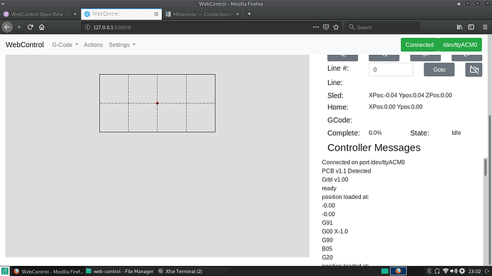

So, it didnt open a socket on port 5000?
I don’t think the problem is with the camera. Are you sure it’s not working? Try browsing to it. The:
is due to the controller port not being set yet.
it does! Webcontrol running on Manjaro!
No ‘com’ ttyACM0 to choose
There’s a little refresh symbol next to the port setting. Click that and it should autopopulate the available ports.
it stays blank

When you click the button, there should be a console message printed that says “at Update Ports”. It’ll appear on the console as well as WebMCP (web port 5001). Do you see that message?
When I tested in Windows 10 I could get serial port to work, until I did an import of my existing groundcontrol.ini.
That was it, missed that, sorry! Great chat tonight without a chat module.
Thanks for this amazing, incredible, unbelievable support!

The terminal after importing, just in case it could help:
connecting
is unavailable or in use
{“title”: “Actions”}
connecting
connecting
/home/maslow/.WebControl/imports/groundcontrol.ini
bufferOn
computing settings
{“title”: “Import groundcontrol.ini”}
connecting
Connected on port /dev/ttyACM0
Sent G20
Sending: G91 G00 X-1.0 G90
Sending: $$
Sending: B05
1.26
WebControl 101.25
Firmware Version 1.26
