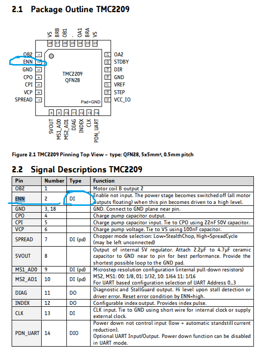

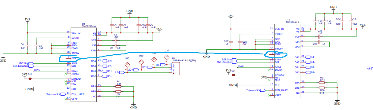

Are the TMC2209 ENN Pins unconnected and floating? If so, is that intentional because enable/disable happens via UART?

Have been looking at https://github.com/MaslowCNC/Boards, asking because I’m used to seeing ENN pin driven by a GPIO, or, tied to GND to keep drivers always enabled. Sorry if this is a silly question, am relatively new to driving Stepper motors directly, related chat. Am learning by digging around projects I like, and was curious about this observation.

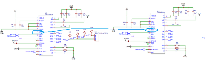

4.0 and 4.1 schematics show TMC2209 pin 2 floating…

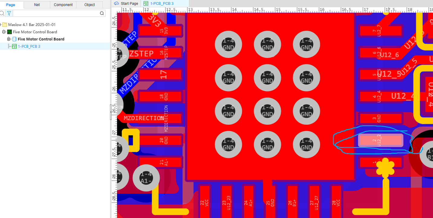

PCB shows pin 2 is not connected…

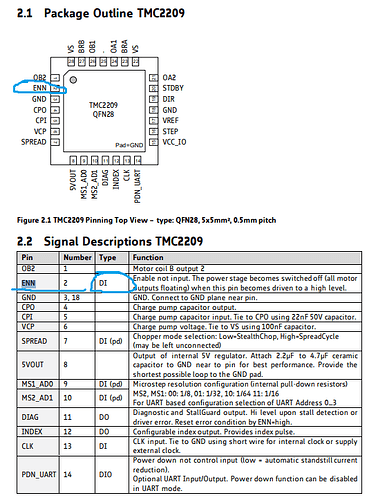

TMC2209 DataSheet doesn’t mention any pull down resistor, so unconnected behavior is undefined?
I haven’t physically inspected a board (e.g. test resistance between Pin 2 ENN and Pin 3 GND), partly because of eyesight and dexterity needed to precisely probe continuity of those TMC2209 pins.
I haven’t closely inspected the firmware to see if/which GPIO Pin toggles ENN pin. Maybe the schematic and PCB design snapshots from GitHub that I’m looking at are outdated?
