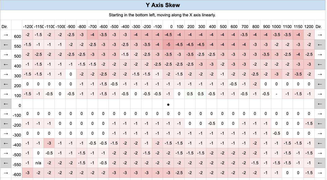

Data
I recorded the skew for each point from the origin of that row or column as signified by the blank cells. The X and Y axis skew data was recorded separately to make the visualization easier, but the google sheet has coordinates if someone wants to use that data.
Here’s the google sheet
Findings
  1. I think the big finding here is that the accuracy is almost the opposite of what the hypothetical frame calculator suggests near the edges.
  2. What I think this data shows is that belt angle or tension of the non-pulling direction is the most important factor. Since the machine is making rows of dots on the X axis, I’ve indicated what direction it’s moving for each row. For example, with the machine moving to the left away from the right side of the board near the middle, the belts opposing the movement (TR BR) struggle to hold the M4 in place and are over powered due to the angle of the belts on the far side (TL BL) which are pulling more directly. You can actually observe this when calibrating near the edge, the machine stops and when the belts tighten it is pulled toward the center. When the machine is in one of the corners, the nearest belt has less angle and can thus hold the position much better - but again this has a lot to do with direction.

The first observation I noticed in data is that the skew is always negative, I think this is because the longer belts always apply force more directly due to less angle.
The second observation is that I noticed is that moving toward the center has more negative skew. I believe this is because in Figure 1 the force toward the center of the board is greater because we have angle A<B and the machine can pull harder in this direction compounding the first observations issue. In figure 2 the long belts are spooling out and the issue isn’t as bad but because A>B there’s less force in this direction (assuming the motors always pull at the same force.)
Third observation, is the corners tend to have less issue because the closest belt has less angle.
Basically if the force/tension/movement from the machine is always equal, the applied physical force is going to change depending on where the machine is and what direction it is moving.

My initial thought was that stretching was causing this issue, but if that was the case I think we’d see the complete opposite skew.
Theoretically stretching would happen more on a longer belt and we’d see a positive skew when the machine is at the edges of the workpiece, not negative. Also, in relation to movement, in figure 1 where the machine is moving toward the center, stretching on the longer belts would mean less skew, but we’re seeing more in this direction.
One more observation, the top left quadrant seems to buck the norm of skew being worse while moving toward the center of the board on the X axis. Not exactly sure why.
The top left has the steepest angle in the belt since the TL arm is the highest. That could contribute to it being different than the others.
that is the top arm, so a slightly longer belt and the arm may flex down a bit
more???
