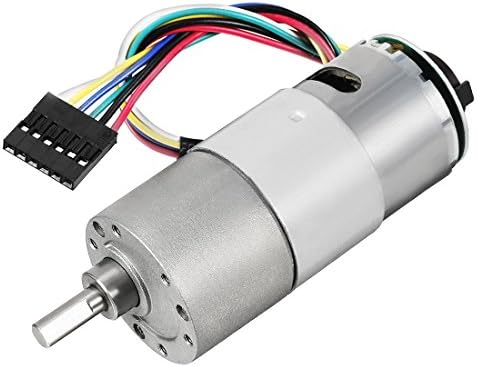

Do you guys think this would replace the stock z axis? My options are a bit more limited being in Canada.
I need a bit more speed and this one looks to be high enough torque but not crazy amperage draw.
Thanks
possibly, note that the stall torque of this motor is 3A, that’s enough to blow
the stock motor controller chips
