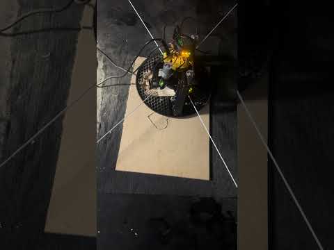

Installed 0.69.2 and the calibration process went much more smoothly. No excess belt , and it finished with a fitness of 0.5403331694322719. (Log attached)
Jogging around feels nice so im going to try a cut… wish me luck :slight_smile:
m4 log.rtf (43.7 KB)
Success!
Quickly sketched a 100mm circle, square, and heart in Sketchup and used kiri:moto for the CAM.
Only doing a 0.5mm DOC as I wasn’t sure on speeds and feeds yet. Bed time now but tomorrow I’ll start cutting some full sheets for a project thats been waiting for Maslow.
