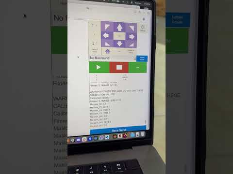

Maslow-serial-5.log (4.8 KB)
Increased frame size to 12’x8’. Tried 500x500 calibration - still endless fitness loop.
Trashed my .yaml and uploaded the latest firmware .yaml. Tried starting over. Same problem. Endless fitness loop.
[MSG:INFO: Top Left pulled tight with offset 0.000]
[MSG:INFO: Bottom Left pulled tight with offset -0.011]
[MSG:INFO: Bottom Right pulled tight with offset -0.043]
[MSG:INFO: Top Right pulled tight with offset -0.032]
[MSG:INFO: Center point off by: TL: 0.000 TR: 0.000 BL: 743.546 BR: 601.972]
[MSG:ERR: Center point off by over 100.000mm]
[MSG:INFO: Frame size automaticlaly adjusted to 3189.821289 by 3189.821289]
My actual frame size is 12x8’ (3657x2438) so I’m not sure where the 3189x3189 numbers are coming from.

@boslaw I was finally able to escape the endless fineness loop, by setting the force to 1500 and grid to 3x3 and 300x300. Maybe give that a try…
Thanks @BarryRalphs - if you scroll back through the thread, @dlang says that 9x9 should work, @bar says 5x5 should work, now you say 3x3 should work. I’ve tried them all. None work. It’s the same situation every time. I’ve tried many times and many ways over a period of a few days.
  1. I’ve increased my retraction force from 900 to 1500 in increments. Doesn’t make a difference.
  2. I’ve retracted and extended my belts so many times. Makes no difference.
  3. I increased my frame size from 8x10 to 8x12. Makes no difference.
  4. I’ve upgrade the firmware, yaml, index to the latest. Makes no difference.
  5. I’ve attached my logs to this thread.
  6. @Betalombo suggests that my distance between belts Bl and Br is too large (not sure what that means) but those numbers change every time I retract, extract, calibrate. I’ve had:
    Center point off by: TL: 0.000 TR: 0.000 BL: 682.859 BR: 627.421]
    as well as
    Center point off by: TL: 0.000 TR: 0.000 BL: 51.861 BR: -19.326]
Everyone seems willing to help, which is great, but no one really seems to be able to help because no one really seems to know why this happens and how to fix it. Many people post the same problem in the message boards (repeated fitness errors) but I have not seen a single, repeatable, set of instructions to fix the problem and get cutting.
I hear you - I’m also going through the motions of trying to get my machine up and running but it’s essentially a work in progress machine, and seems to have a pretty great community supporting it. Unfortunately the price tag comes with the lack of documentation and thorough troubleshooting, because it’s literally being worked through, just one of those tradeoffs.

Here’s a link to the video of my calibration if this helps anyone diagnose what is causing my issues.
It’s a huge challenge to understand Maslow, and to make it work, you need to familiarize yourself with his language. I don’t think anyone can say exactly what to do, as there are so many variables, from the assembly process to the firmness and size of the frame.
BL is abbreviation for Bottom left belt and BR is abbreviation for Bottom right belt, TL: Top Left, TR: Top rigth
