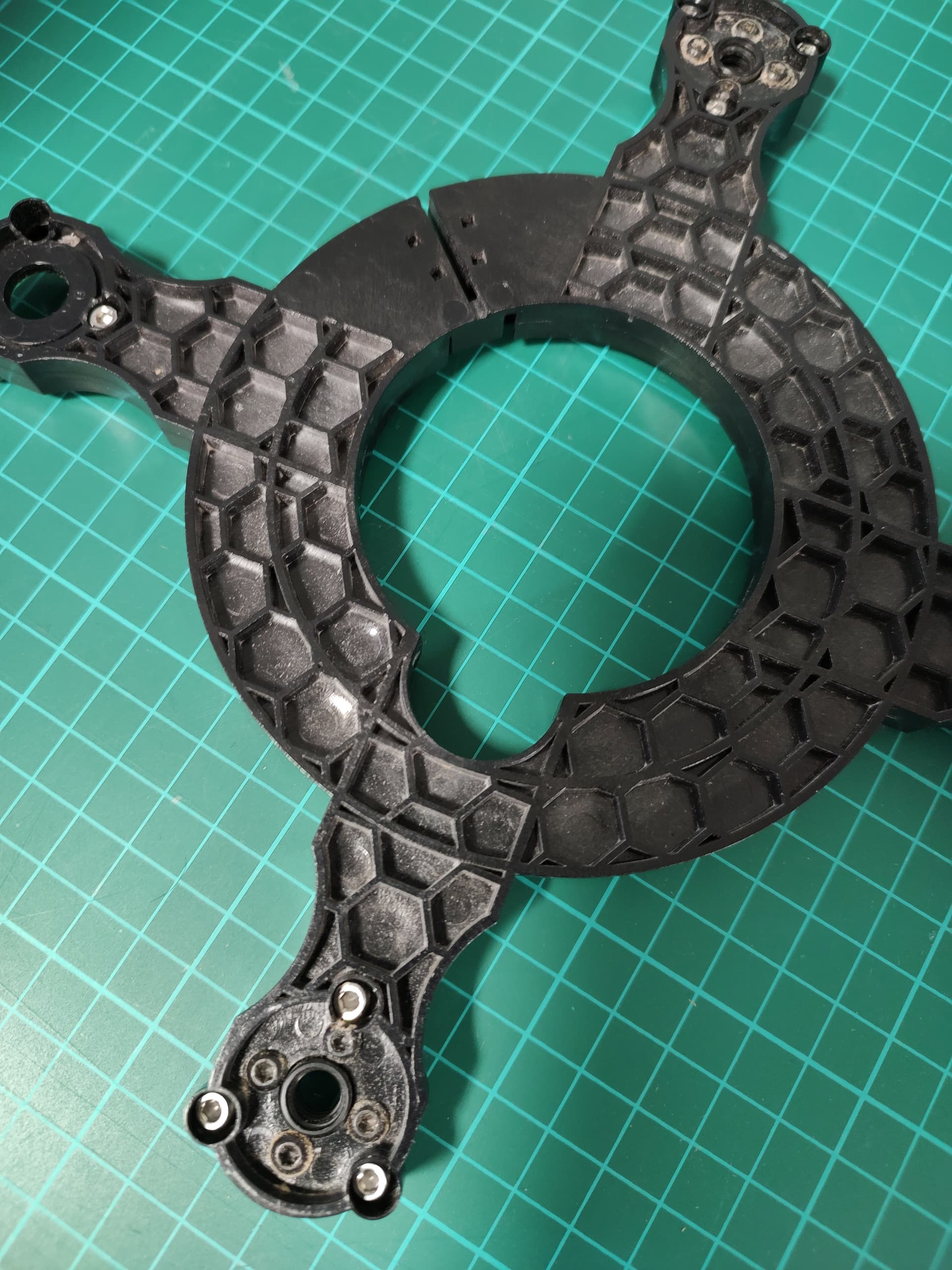

Yeah, it’s always the right one. Do you mean these three screws at the top? I hope you don’t mean the bottom ones, because that does involve quite some disassembly each iteration.
I do, but from memory I oriented mine in such a way that the screw heads are on the bottom.
I think I have a photo somewhere I took for something else, let me find it :thinking:
Not the best photo but might give you an idea - this is looking at what will be the bottom face once every thing is put back together. Most of the delrin nut is on the other side, with the long threaded side poking through (not sure that makes sense).
