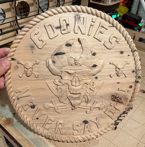

@CGDrummer your 1st method is similar to what some CNC CAD/CAM programs call tiling and is basically used for lager jobs to be cut on smaller machines. It takes some practice to get it figured out and you need pretty good precision to get it to ensure your cuts align in the correct manner. Can it be done with the Maslow, I’m sure it could, but as @dlang has already mentioned, when doing 3D relief carvings, a lot of material can be removed, causing the surface the Maslow rides on to diminish, and can cause a failure. This is the #1 reason I bought a second CNC that was a gantry machine so I could do 3D relief carves as it was something I wanted to add to my capabilities. I can say it cuts way faster than the original Maslow (nothing against that), and I have still had cuts that will last 4+ hours on that (both roughing and finish passes each) at approx 100IPM (rough) and 150IPM (finish). 3D relief carves just take a long time, and it increases exponentially the larger the project is.
This is one I did recently for a friend of mine. Measures around 12in across, and about 1in thick (started with 1.125in stock). Rough was about 2.5 hours, and finish was 4-ish hours IIRC. Was done in Pecan.
Was the Goonies done on the maslow? Would you be willing to share your files?
Unfortunately, it was not done on the Maslow as the size and depth of cut needed would not be supported by the sled, and it would have taken waaaaaayyyyyy to long (even with my Meticulous-Z I have set up). I wouldn’t really mind sharing the file, but it was a paid file, and I need to check with the site that I purchased it from to ensure I would be able to. It was not my creation and I do not want to cross any lines by sharing. I’ll get back to you on that as I figure it all out.
