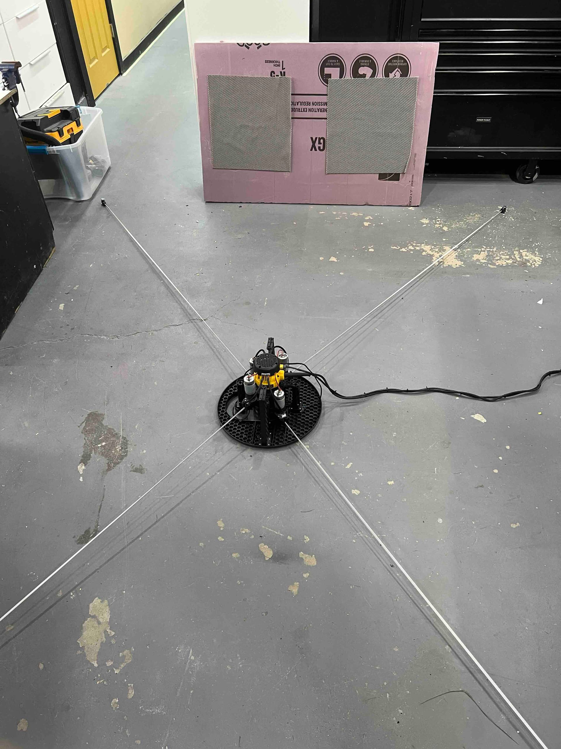

So, I got it to calibrate! And have a few new questions.
I set the grid area to 30.5” x 48” (out of my total 88 x 121” frame area). It wouldn’t let me do a 3x3 or 5x5, and it went into a fitness loop with 9x9. But 7x7 worked.
The belts unwound a couple times at the start of the calibration, but didn’t get tangled and wound themselves back up. I didn’t apply force to simulate it being on a vertical / wall-style frame.
The retraction issue with the one belt went away. Perhaps and friction in that arm’s belt guide got rubbed out.
I don’t know what belts went to which anchor last attempt, so perhaps I unknowingly did a 90 degree reorientation.
Another change from my first attempts was getting the robot off the foam (like what Bar uses in his home garage) and directly onto the ground. I assumed being on the foam would be a more accurate representation of the jobs, but perhaps not??

Added here are some photos of my setup and config settings used.

Please remind me does the calibration calibrations run on Maslow PCB or on our computer?
If on computer the age /performance of the computer may take longer to calculate ?
Dano
I note you have orientation set to vertical but you a running on the floor, should be horizontal
Calculations are on the computer and speed of computer makes a huge difference.

20+ mins of restarting fitness… no change
