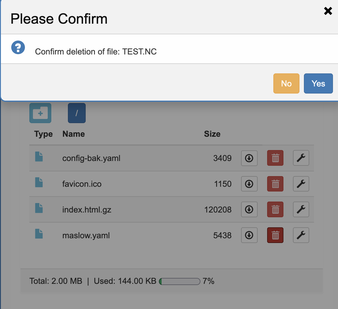

I received my new belt and tried to recalibrate, but got errors about the yaml. restarting didn’t help and when I tried to delete the yaml and index (with the intent to update to 1.04.1), it asked if I wanted to confirm deletion of a text.nc file. I cant seem to delete the yaml or index to start a fresh calibration.
Here;s the serial file
Maslow-serial(1).log (3.1 KB)
I get the same thing on my 4.0 when I delete the yaml - test.nc is deleted, no mention of maslow.yaml
Same here!
Same here!
