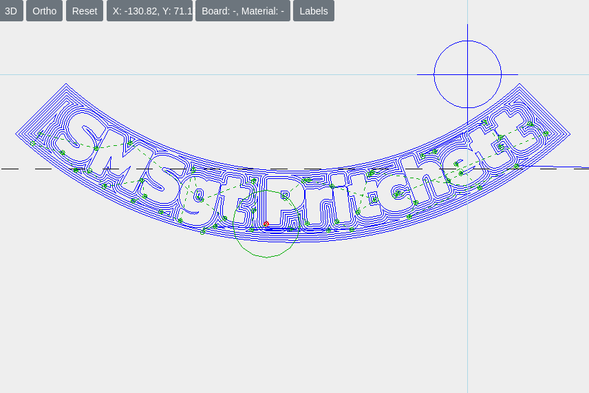

Here are a few web control pics from gcode I cleaned up, split and merged. The original gcode was created with Carbide Create v6 build 652. According to GCC my original traveling distance was 12,192 and new traveling distance is 1,165! I am cutting it now.
Good quality cut with no seen issues. Took 33 minutes with a .15" pocket that took 2 passes. Pretty happy with the quickness, this would of been near an hour with the old gcode.
Those numbers are in the units of whatever you used in your GCode. I’m going to guess metric (so millimeters), in which case travelling was reduced from 12.8m to 1.1m
And that also tells me that Carbide Create has a terrible algorithm for planning this out.
