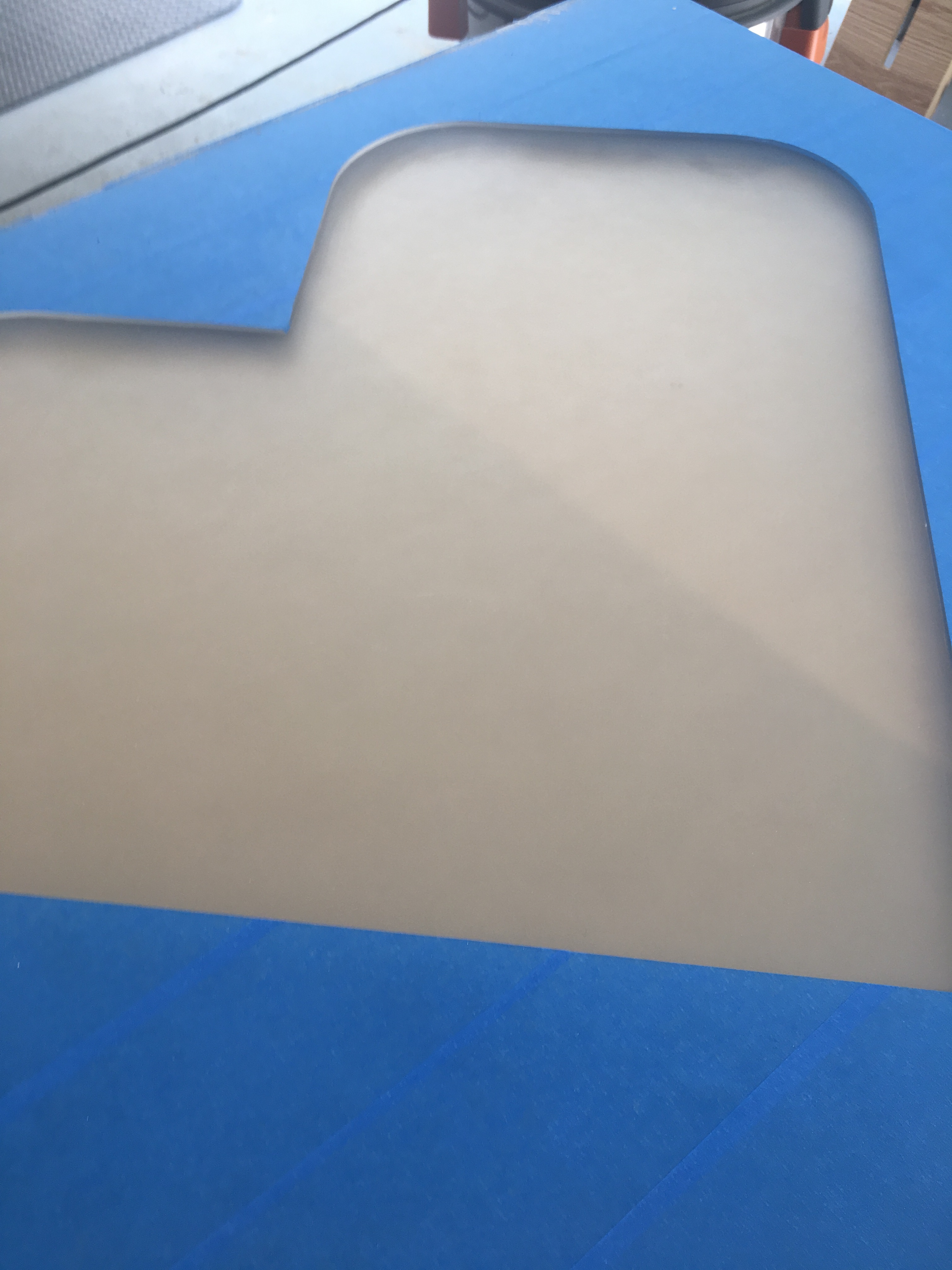

This was a project from last year I cut and carved on a 3/4" acrylic.
And here is a Project from couple weeks ago
10000 RPM with a single flute bit.
Another one from last year…this one was a project for my brother, I made 20 of this and send it down to Brazil
My Brother added the sticker as I could not carve that.

10000 RPM with a engraving bit

how deep did you cut and how many passes
The CVS health was 5mm and 2 passed, 4.5mm 1st pass, 0.5 second pass
The game controller was done with 1 pass at 0.5 mm
thx what was your feed speed i want to try one so 10,0000 spindle at .5 mm depth feed ?
and through all at 4.5 mm ?

@MGSR yes it was at 10000 at .5mm
and for the 4.5mm 1st pass I started at 13000
