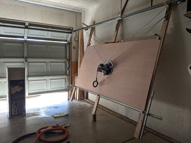

I sketched up a design with 3 straps to suspend three 2’x4’s with a 10’ unistrut between them as a top beam. To mount the top beam, I cut three 2 foot long unistruts into 1-foot long pairs to fashion adjustable L-brackets. One leg of each bracket is bolted to a 2’x4’, and the other leg will suspend the 10’ unistrut.
Yes, I’m using these alternate sized gate strap hinges and i use the longer side on a 2x6 affixed to the wall and the thinner side on the top of my top beam. It holds just fine and the frame hangs about 0.5" off the ground when it is laying flat against the wall.
@multibeast, what is your frame made out of and how do you prop it out at 15 degrees? I used a unistrut top beam, but only wood 2x4s for the vertical beams and there is a lot more warping than I expected. For adjustable legs, I used 3/4" conduit tubing attached to a lower unistrut rail.
Here I propped up the frame to figure out how long the legs need to be to get everything level.
@explorien my frame is made out of 2x4’s similar to yours but with added 2x4 cross beams on the top and bottom. Everything is pocket screwed together and then i have a 1/2 inch wasteboard screwed in. Told it off the wall i have (2) 2x4s hinged from the bottom rail so that when i pull it away from the wall they fall out and create 2 standoff points for me. A bit of a pain to pack them back up without a second set of hands, but it holds pretty stiff when in place. To figure out how long to cut them i just kept pulling out the frame until i found close to 15* and measured from there.

how far out depends on your sled/router/weight combination.
You first want to setup your sled so that when you hold it in the air by the
chains, it hangs straight (adjusting the height of the ring from the sled), this
way as the chains pull on the sled, they won’t be trying to tip the sled.
Then you want the motors so that as the sled sits on your workpiece, the chains
are parallel to the workpiece.
The design of roller chain and sprockets allows for up to a 3 degree angle, but
that’s a max that you should not get near.
This doesn’t have to be exact, but you want it close. in the upper corner, when
the chain length gets as short as ~10", you want the motors to be no more
thanabout 1/2" from the height of the ring.
if the difference is too much, the chain will skip.
