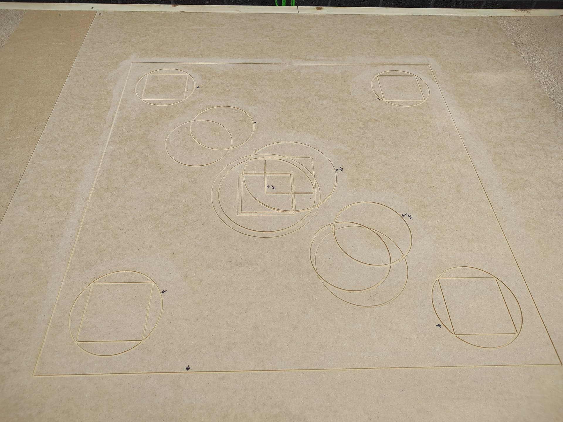

Ok, so the update for this - more testing shows some interesting stuff.
I re-ran with router-on, no-bit-no-vacuum. I still saw the issue.
I re-ran with no router on and it failed once, and succeeded once, or more accurately seemed to recover once.
I was able to tweak some stuff and get a full cut (and a decent level of accuracy):
(the second is sanded to remove the cut fluff, and the black arrows are to tell me which ones at from this cut).
So, i’m now slightly suspicious of what’s happening with the G0 movement.
When it succeeds these fast-diagonal-G0 commands, what seems to happen is:
  • The trailing belt goes slack right at the beginning of the move.
  • It zooms off with the 3 leading belts tight and pulling.
  • The trailing belt slack pulls in as it reaches the end of the move.
The only difference with the failing ones is it appears it happens to move about enough because of the slack that the ‘Position error’ is triggered.
Now the interesting thing is - I tweaked my file so the G0s were all replaced with G1s with feed rates. Nothing crazy, I tried F600 and then F1000, so (third line):

And the belts stayed tight throughout the travel, and i was able to do my full test cut above, router on, vacuum on.
I haven’t delved into the code yet, but I wonder:
  • Is this expected behaviour of the G0 command - perhaps because it’s a fast move we slack the trailing belt?
  • Should the ‘Position error’ check be disabled at the beginning of G0s, and re-enabled at the end?
I need to spend some time ramping up the travel speeds with G1s to see what happens and look into the code for G0s, but it’s interesting. And none of this explains why a specific arm seems to be the trigger for it, but I wonder if it’s sliiiiiiiightly more stiction-y than it’s opposite so more prone to this for some reason.

very interesting. what CAM software are you using? somewhere in the machine
definition there is a feed rate for G0 defined (@bar any chance this is set in
fluidNC???)
if that feed rate is too high, the maslow can’t keep up with what it’s being
told to do and that could result in where it things it should be not matching
where it is.
the PID loop will eventually complain about excessive motor current (4000 IIRC)
but it could be that the PID loop isn’t ramping up fast enough and it’s hitting
the position error first.
figuring out how fast it’s trying to move for G0 and then lowering that seems
like a good thing to do.
At the moment - KrabzCAM, though I might switch to something else.
Having a quick look in FluidNC it has max rates for X and Y separately of 2000. And a max acceleration for each.
I don’t think it’s a coincidence i’m seeing this on a 45 degree move - that would give me the greatest combined actual move after all. It seems like a possible holdover from gantry CNCs to just consider X and Y separately.
If I want to stick to 2000 speed, I think I need to dial it back to about 1400 for the hypotenuse / combined vector to be under 2000 :thinking:
So i’ll give 1400 for X and Y a go with the G0 file when I next get a chance.
I think that this is a PHENOMENAL test. You did a really really good job of identifying exactly the issue I’m pretty sure.
This is exactly what is going on. The G0 command basically tells the machine to move “as fast as possible”. The question then is “how fast is that?” If we tell the machine to move 9999999999mm/s it’s obviously not going to actually keep up and then we get that error message.
We can set the speed limit in the settings like this:
(I’m pretty sure that will set the limit)
The problem is that those settings were designed for a traditional XY machine where we know the max speed in X and Y…unfortunately the max speed in X and Y for Maslow is going to be different depending on the frame size and also where on the frame we are.
I think that maybe the real solution is that we need to set a max speed per belt, but that’s going to require some significant changes to how we interface with FluidNC.

I don’t think there is anything special about that 2000 speed, I think it’s
probably the fluidNC default, so it may be that we need to dial it back further
for the maslow.
Yeah, 2000 does sound like an arbitrary default!
Though it did occur to me as another relevant question - when I set a Feed of n, is it calculating the vector so that it’s n, or is it doing limiting the X travel and Y travel to n each? I assume it’s calculating the vector to be a travel speed of n.
So i’ll try my diagonal G1s at 2000 I think as a next test and see what happens!
it is calculating the travel speed along the path
and also try them at 3000 (~2000 each in x and y)
also note that the load on each arm will be different in different locations
@bar, what is the rated speed of these motors under load?
They’re rated for 50rpm I believe, but how much distance that translates too will depend on the amount of belt on the spool…although we can just make a conservative estimate of assuming no belt on the spool.
ok, 50 rpm X 11 teeth on motor / 82 teeth on spool x 2 x pi x 44.5 radius= 1875
mm/min
we should probably derate this in case there isn’t full voltage/current
available, so a max of 1500mm/min (40 rpm) is probably a safer number to plan.
