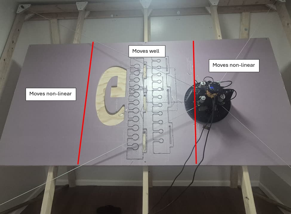

Hi all,
I’m running into an issue with my Maslow 4.0 during cuts. The lower right belt keeps loosening and ends up unwinding inside the belt spool.This happens partway through the job. I’ve already done a successful cut on the left side of the frame. This is the first time doing a cut in the right side of the frame.
Has anyone experienced something similar? I’m trying to understand what could be causing this and how could I try and fix it.

Can you get a video of it happening?
The first things that come to mind are that it could be a calibration issue (running calibration again might fix it) or it could be a lose magnet in one of the rollers.
Does it happen exactly the same every time?
If you move the machine back to the left side of the frame does the belt tighten up or stay lose?

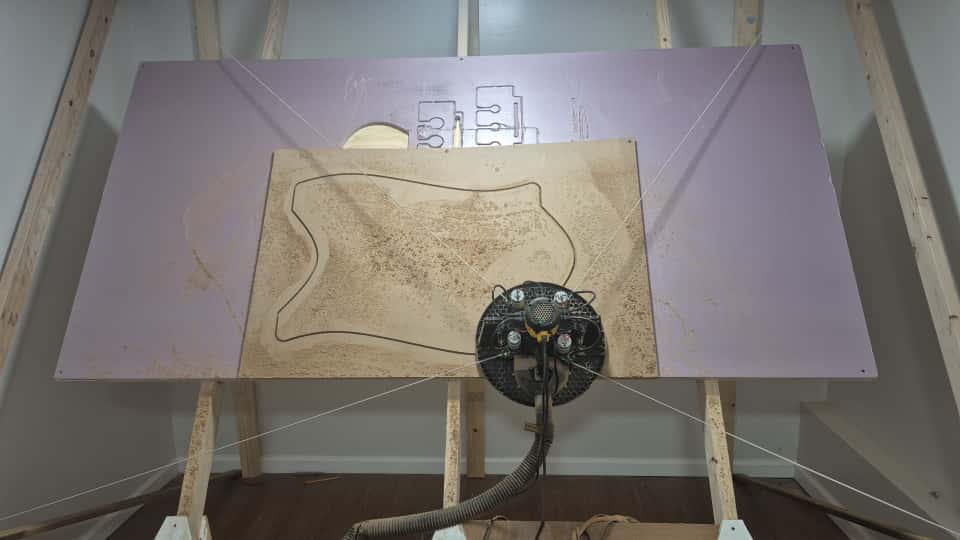

I have the same issue however with the lower left belt while working on the left side.
I’ve been cutting in the middle with no issues, only did a 800x800 5x5 calibration.
I’ll run a new more ambitious calibration and report back.

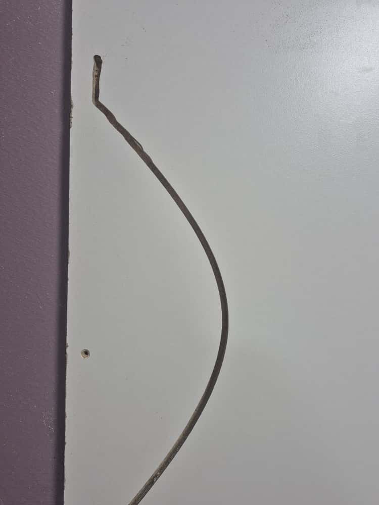

I ran another test before calibration as I would have to remove the stock to calibrate.
The same thing happened and the cut failed the same way.
It was the second time so no stock was removed. I took some videos and can add the serial output

During testing, I observed that the Maslow’s motion varies across the frame:
  • In the center portion of the frame, it moves and stops smoothly.
  • In the sides of the frame, the maslow appears to move non linearly and have a slight recoil after it stops positioning.
Please find attach a couple of small videos of the maslow moving. One is the maslow moving on the mid portion of the frame, and the other is on the right side.
What could be causing this behavior?
Thanks,
Jose
Ps: I have also attached the gcode you asked.
cup holder vertical v2.nc (85.0 KB)
I didn’t see anything in the video which jumped out to me as being particularly out of the ordinary.
How tight are the belts. Does it feel like they are too tight in the areas where it isn’t moving the way you would like it to?
So, today I extacted all the belts lenghts and retract them with 900 force, no issues. Then I recalibrated the maslow using 1200x800 and 7x7 grid with calibration force of 1400.
I moved around the maslow, but the smooth zone more or less remainning the same as previously pictured. So, I decided to make a cut of something that fitted inside the middle zone.

I made the design bit smaller too fit in the middle zone, and was able to successfully cut 3 of this pieces with good repeatability.
Regarding the calibration force, I increased it base on the suggestion by JitM. I see the machine moving better with higher calibration forces. Maybe this is a lead on what could be wrong in my setup?
