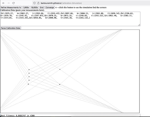

I pasted the measurements from the log file into the calibrations simulator and two things stood out to me:
  1. The points aren’t really in a grid at all which isn’t normal
and
  1. The simulator was able to pretty quickly solve for values for the anchor points from that set of measurements so I’m not sure why it didn’t give an answer

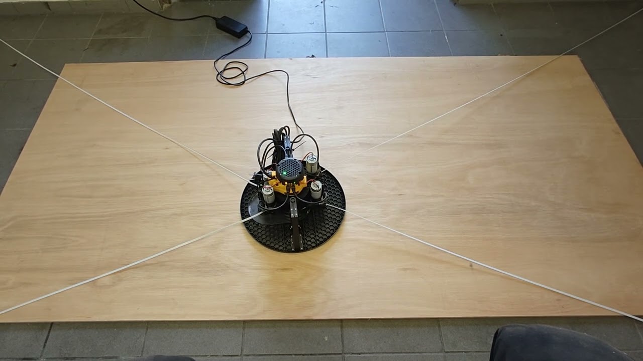

It does start with measuring a couple of waypoints. (waypoint 0 to 5)
I made a video about when it’s measuring the waypoints. Then it stops and tries to calculate the anchorpoints. (The small black dot on the wasteboard is the middle)
It doesn’t look like the points in the calibration simulation match the points the machine is doing.
Thanks!
If I put in the same calibration data (from the last log file posted here), and press on Parse Calibration Data, it shows something different, When pressing Converge, it is not able to find a good fitness. (I could be using the tool wrong)

One other thing that I noticed in the video is that you have things set up 90 degrees from the usually setup where the power cord is towards the long side of the wood.
In theory that shouldn’t matter, but I just haven’t done much testing in that orientation.
Thank you!
Oh, indeed :sweat_smile: I will recalibrate it with the power cord at the correct side. It will be easier for the dust collection as well. Thanks for noticing!
