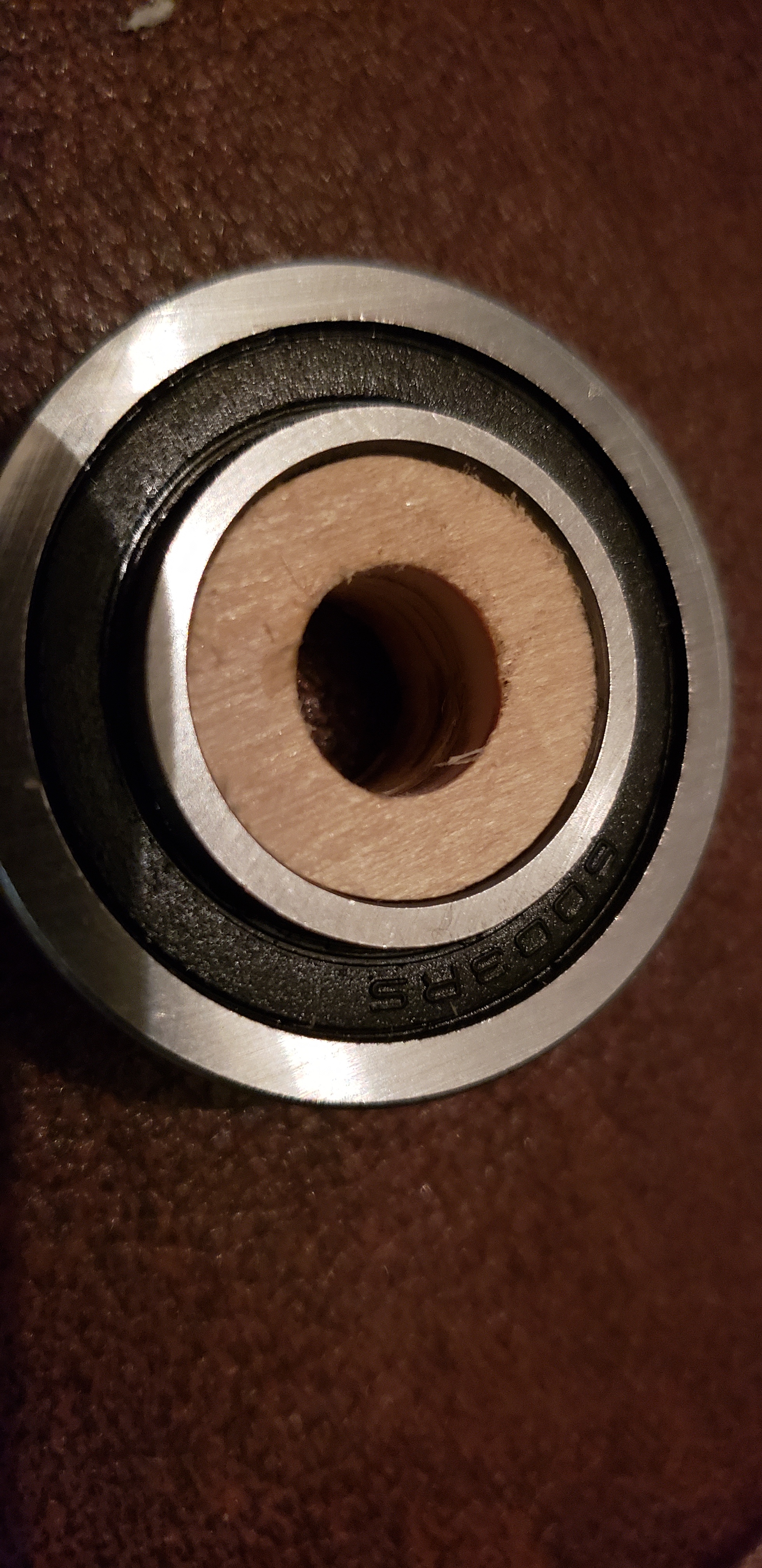

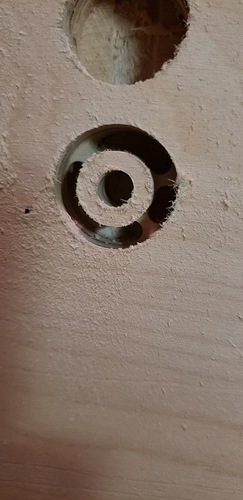

I’ve been trying for several hours to create a simple part in FreeCAD. I have it created and when I run the simulator, it looks great. Unfortunately, the Maslow won’t use it to cut. The main problem appears to be that the Gcode is using all positive Z positions.
All I need is a cylinder that is 19mm in diameter and 13mm tall that has a 10mm hole through the center. I can 3D print it from my model, but I need it in wood. If someone could walk me through creating this in a way that work, I would appreciate it. I have been using the PART workbench for a while for 3D printing, but not the PART DESIGN workbench, which for some reason it completely different and utterly confusing.
So, I created a Body from the 19x13mm cylinder, then another body from the 10x13mm, then did a Boolean operation to create a Cut which created a combined Body that looked like I wanted. I created a sketch on the XY plane from this, then added a 13mm Reversed Pad to the Body. I then added a Tool, a Job, and a Contour and Pocket cut for the body. Again, in the Simulation it looks great, but when I export the Gcode with GRBL post Processor, all the Z values are positive. Here’s the output:
