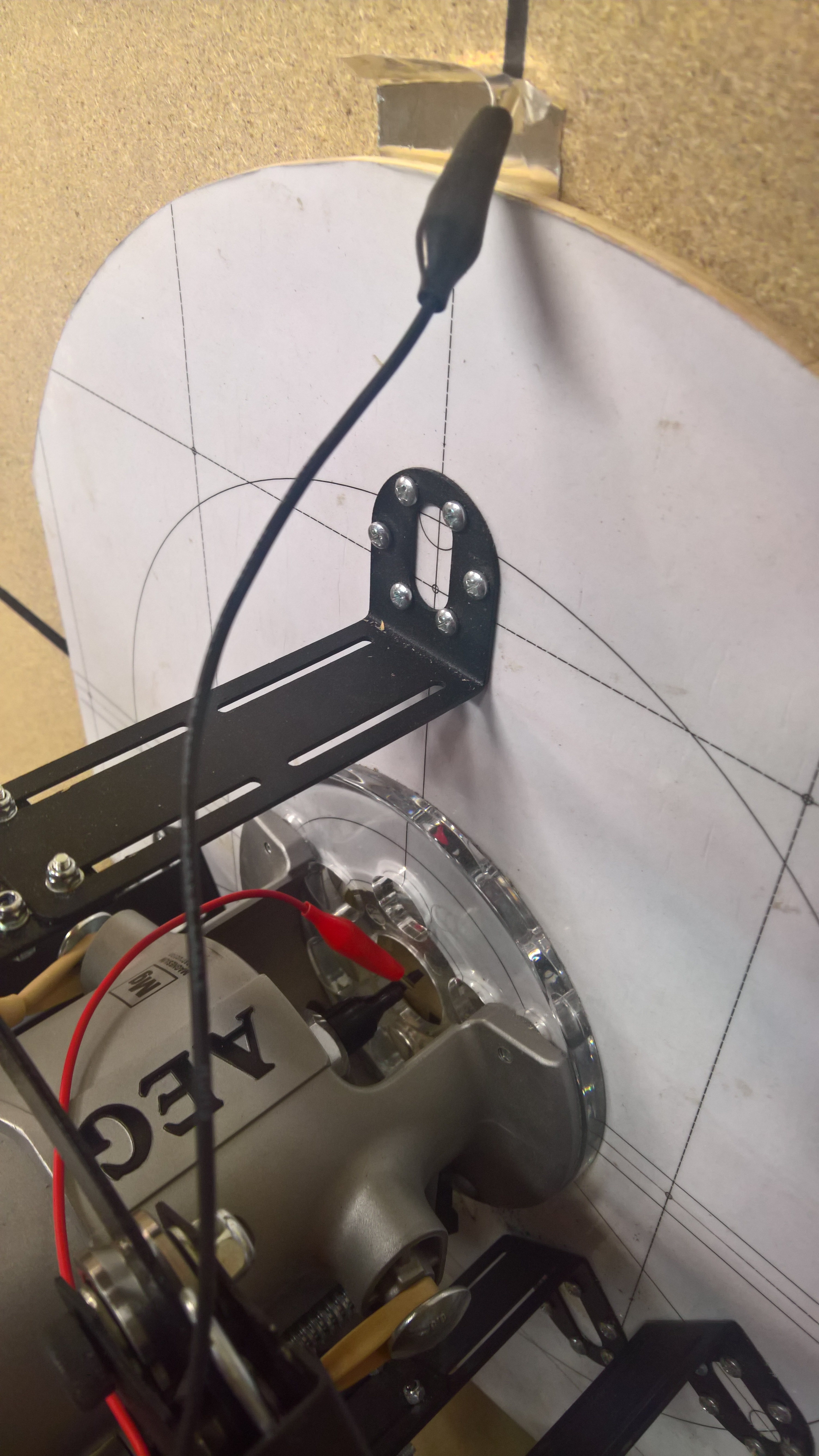

Cheap Film Touch probes for easy Z-axis zeroing

Because the sled height (the distance from the top of the sled where we just Zeroed, to the actual cutting surface) never changes, so we can figure out where the bottom is using Mathemagic.
Edit: I am looking into 0 interaction z 0 options.
I’m was pondering that as part of an automatic bit changing attachment. (Don’t get too excited, it’ll be a while before I can try to make that happen.) For the auto-zeroing after a tool change, I was thinking a motor that moves one of these film touch sensors across the cutting hole in the sled. When you want to auto-zero, the Maslow code will need to:

Cheap aluminium tape.
